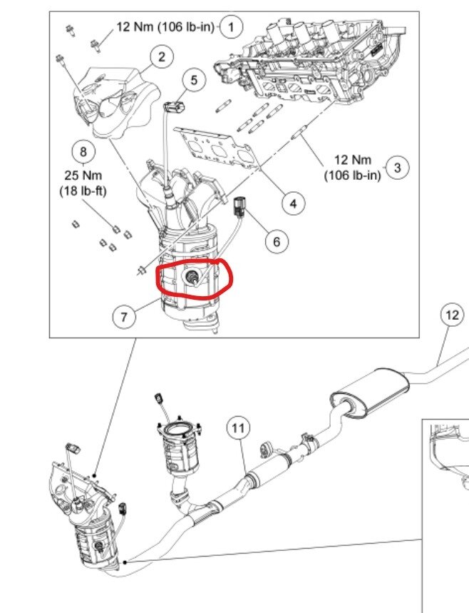

Where is the bank 2 downstream o2 sensor located?
2011 FORD EDGE
160,000 MILES • 2WD • AUTOMATIC
SKYLARJ
Is there anyway someone could send a description of where the downstream o2 sensor is located for the vehicle listed above limited model. I can’t find a video exactly showing, but I do see many comments saying it is more difficult to locate than on other ford edges. If someone could help it would be greatly appreciated, thank you. Attached is the code I got that we want to fix.

The bank 2 upstream is the sensor you see on top of the converter body, the downstream is in the side of the convertor. Bank one is set up the same.
