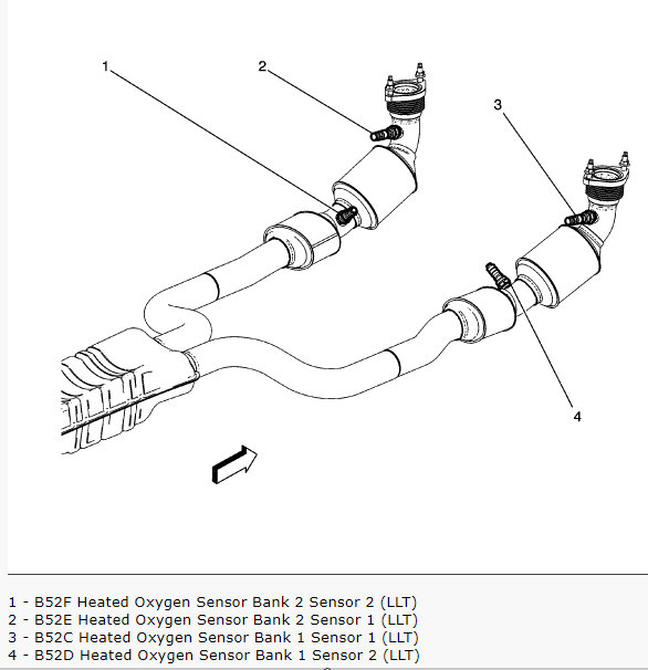

Where is the bank 1 sensor 2 located?

Check engine light.
Wednesday, October 18th, 2023 AT 9:46 PM
BORIS K
MECHANIC
836 POSTS
Bank 1 on your engine is passenger side
Sensor 2 is the downstream oxygen sensor after the catalytic converter.
See image below.
