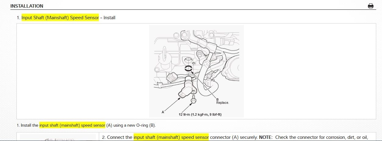

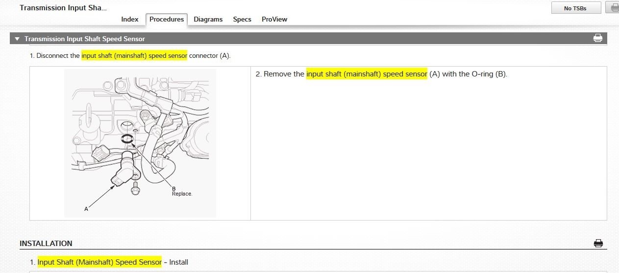

Scanner shows up a problem with speed sensor (PO717).
Part number 28820-rj2-003
Cannot find where is located. Removed a sensor located on top back of CVT but it does not look like the replacement part.
If it is an easy to reach location, I just need to know where is it. If I need to remove other parts, I need basic instructions.
Sep 2, 2017 at 7:04 AM
HARRY P
  • 2,292 POSTS

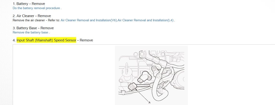

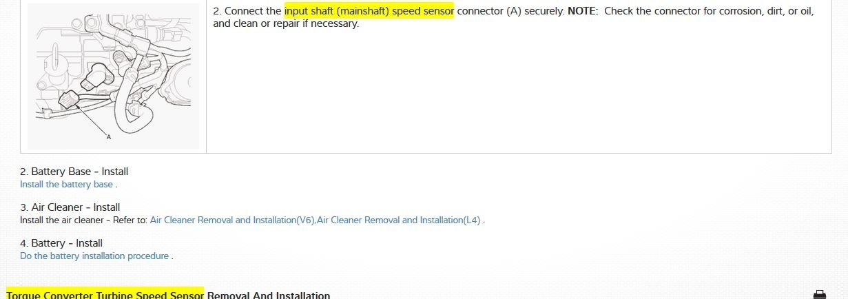

It should be under the battery tray. I will include some instructions in the images.
Sep 2, 2017 at 12:09 PM
STEVE W.
  • 15,295 POSTS
Because it is under the battery I would check the wiring VERY close. Even a single drip of acid into a connector would be enough to corrode the connection and set that code. Replace the part and the code returns because of the corrosion.
