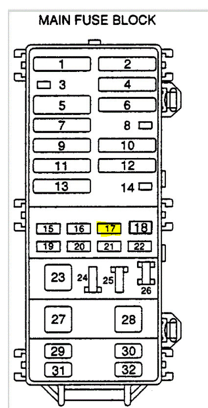

Alternator not charging battery. Checked voltage at the alternator and have no voltage on yellow wire and do have voltage on the green wire when the key is on. Can't find the fusible link between alternator and battery.

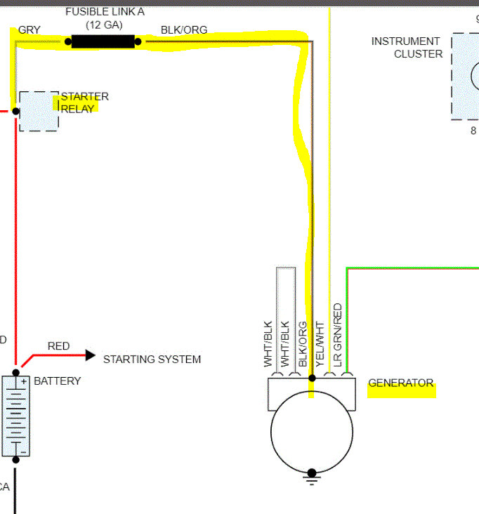

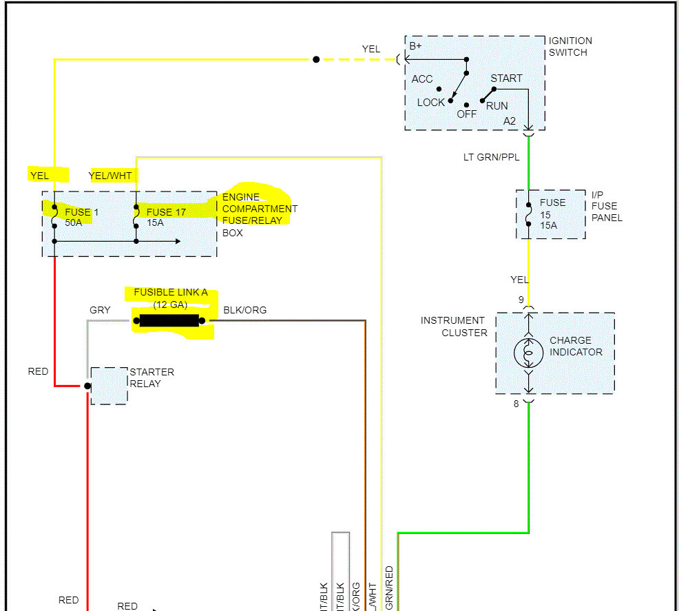

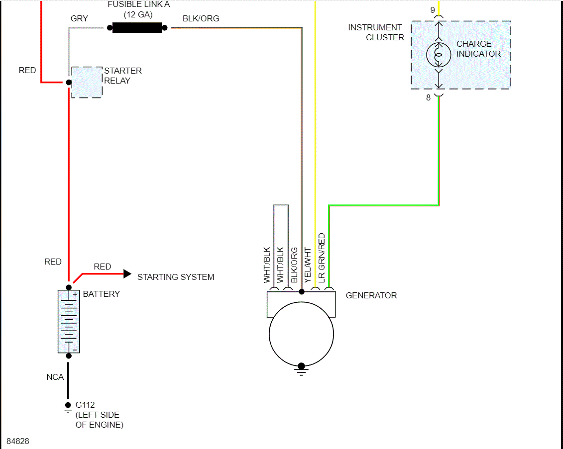

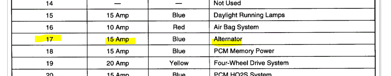

I attached the wiring schematic below for the charging system. If you have no power via the yellow wire with a white tracer, check fuse 17 in the under-hood fuse box. As far as the fusible link, it runs from the starter relay on the left inner fender to the alternator. It starts off gray in color, reaches the link, and then turns to black with an orange tracer to the alternator.
Pics 3 and 4 show the fuse info. Also, I had to cut the schematic in half to make it readable. I did overlap them so you can follow from one to the next.

Thanks, that helped me to find the fuse link. I tested it and it is good, so are all the fuses. The problem must be where the black/orange wire transitions to the yellow wire. Thanks for the speedy reply, it got me on the right path forward.

The black/orange doesn't transition to yellow at any point. It is powered from the fusible link and runs straight to the alternator.
Is there power at the fusible link? If there is and it's good, you should have power to the black/orange wire on the alternator. (See pic 1)
Is there power to and from the fusible link or did you just check it for continuity? If there is no power, go back to the starter relay and check the relay and gray wire for power.
Let me know what you find.

I had voltage at the alternator on the main terminal where the black/orange wire attached. I didn't have voltage on the yellow wire that went through fuse 17, though the fuse was good with the key off and I did have voltage on the green wire with the key on. I eventually took the truck to a mechanic who determined that the alternator was bad, replaced it and changed the serpentine belt because it was developing cracks. He told me that despite what I had read online, the circuit operation was the exact opposite. The yellow wire was supposed to have a voltage with the key on and if the alternator was bad, the green wire would then have a voltage to illuminate the Battery light on the dash. It was too late to test this when I got home but I will in the next couple of days Thanks for your help and following up.

With the new alternator, I checked the voltages at the alternator plug and they were like the mechanic said. With the key on, there was now voltage on the yellow wire and no voltage on the green wire. I guess you can't believe everything you read online. Thanks for your assistance!
