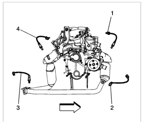

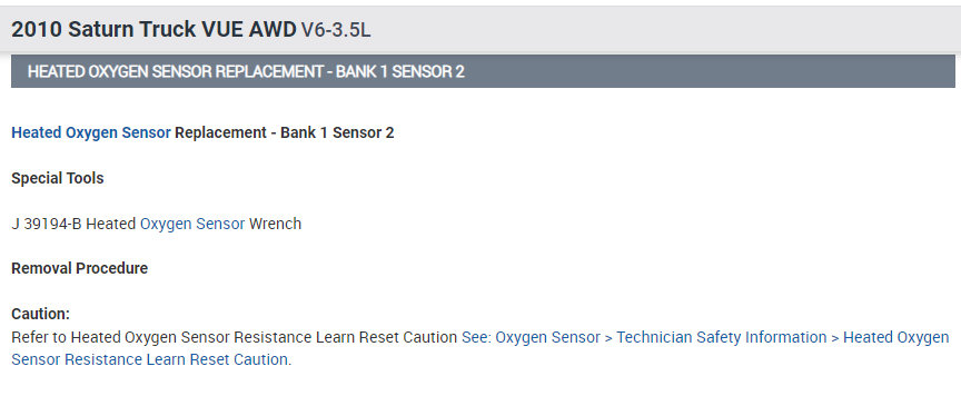

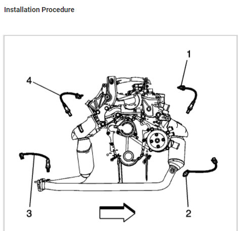

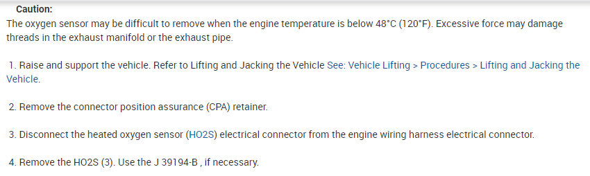

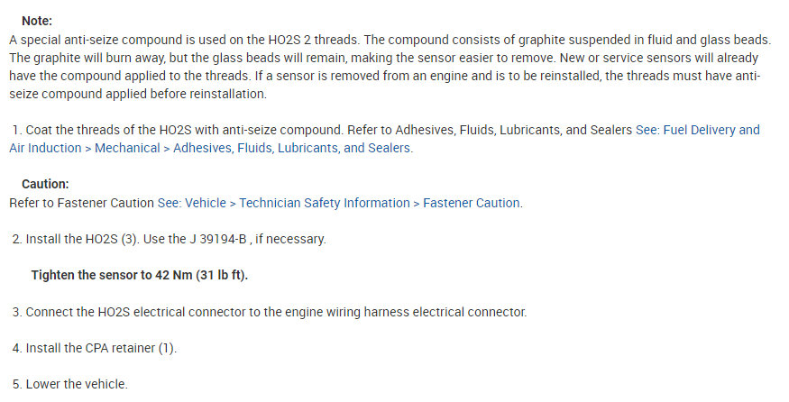

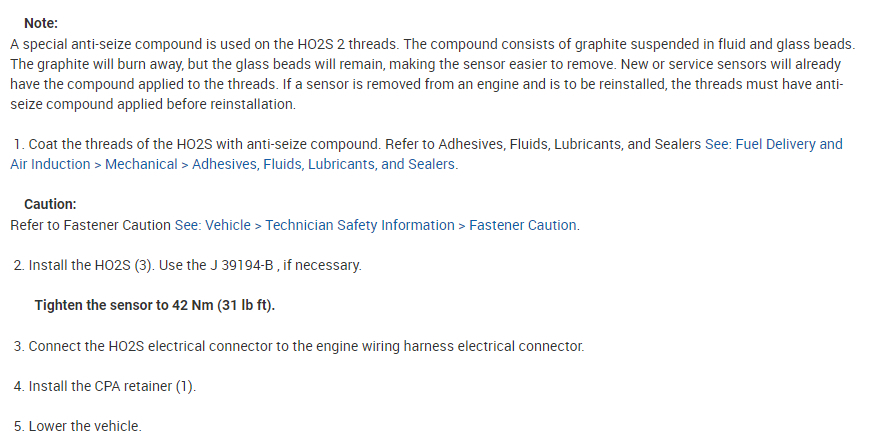

Need to replace the bank 1 sensor 2 sensor.
Mar 6, 2021 at 9:53 PM
DANNY L
Experienced Mechanic
5,648 POSTS
Hello, I'm Danny.
Here is the information you requested. This is a tutorial for you to view on how to replace an oxygen sensor and their function including testing:
https://www.2carpros.com/articles/how-an-oxygen-sensor-works
https://www.2carpros.com/articles/how-to-test-an-oxygen-sensor-02-sensor
https://www.2carpros.com/articles/how-to-replace-an-oxygen-sensor
I've attached picture steps below on how to replace the oxygen sensor bank 1 sensor 2 including its location on your car. Hope this helps and thanks for using 2CarPros.
