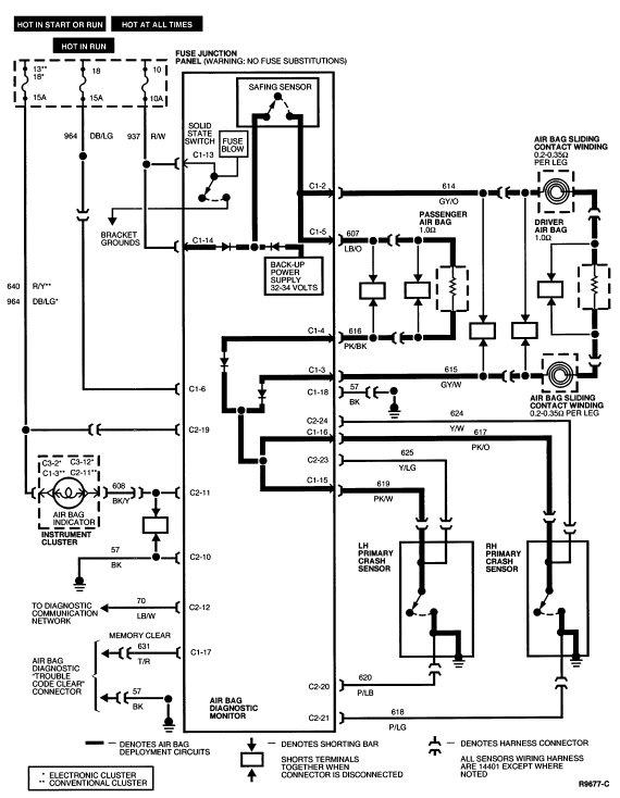

had an airbag code number 12, replaced 10A fuse, now have code number 52 indicating fuse fixed. Need to jumper air bag monitor code reset plug to clear code number 52 and reset (turn off air bag light). Cannot locate, looked everywhere under passenger dash panel under glove box but cannot locate. Should be a two wire plug that needs to be jumped across to clear the fault code and therefore cause the air bag light to now turn off.

If it is the one I remember it is above the glove box tucked in the harness. You can also back probe pin 17 on the air bag monitor and short it to ground to do the same thing.
Schematic showing the connector and its pinout.
Pin Number Circuit Circuit Function
1 — Not Used
2 614 (GY/O) Air Bag Driver Feed.
3 615 (GY/W) Air Bag Driver Return.
4 616 (PK/BK) Air Bag Passenger Return.
5 607 (LB/O) Air Bag Passenger Feed.
6 295 (LB/PK) (Town Car) Fused Run Only Feed.
964 (DB/LG) (Crown Victoria, Grand Marquis) .
13 937 (R/W) Air Bag Diagnostic Monitor B+ Feed.
14 937 (R/W) Air Bag Diagnostic Monitor B+ Feed.
15 619 (PK/W) LH Primary Crash Sensor Feed.
16 617 (PK/O) RH Primary Crash Sensor Feed.
17 631 (T/R) Air Bag Diagnostic Memory Clear.
18 57 (BK) Ground.
