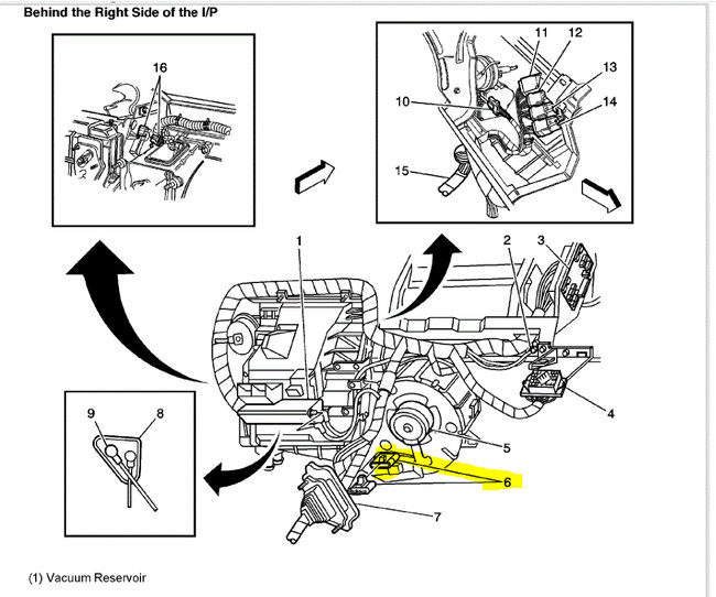

A/C was wiring cube until about 2 months ago my A/C would only work in the high position. Then the other day while driving, my A/C completely stopped working. I checked my fuses, and all checked good, so I wanted to check the relay next but I’m not sure exactly where it’s located at.
May 23, 2022 at 7:43 AM
  • 110,244 POSTS

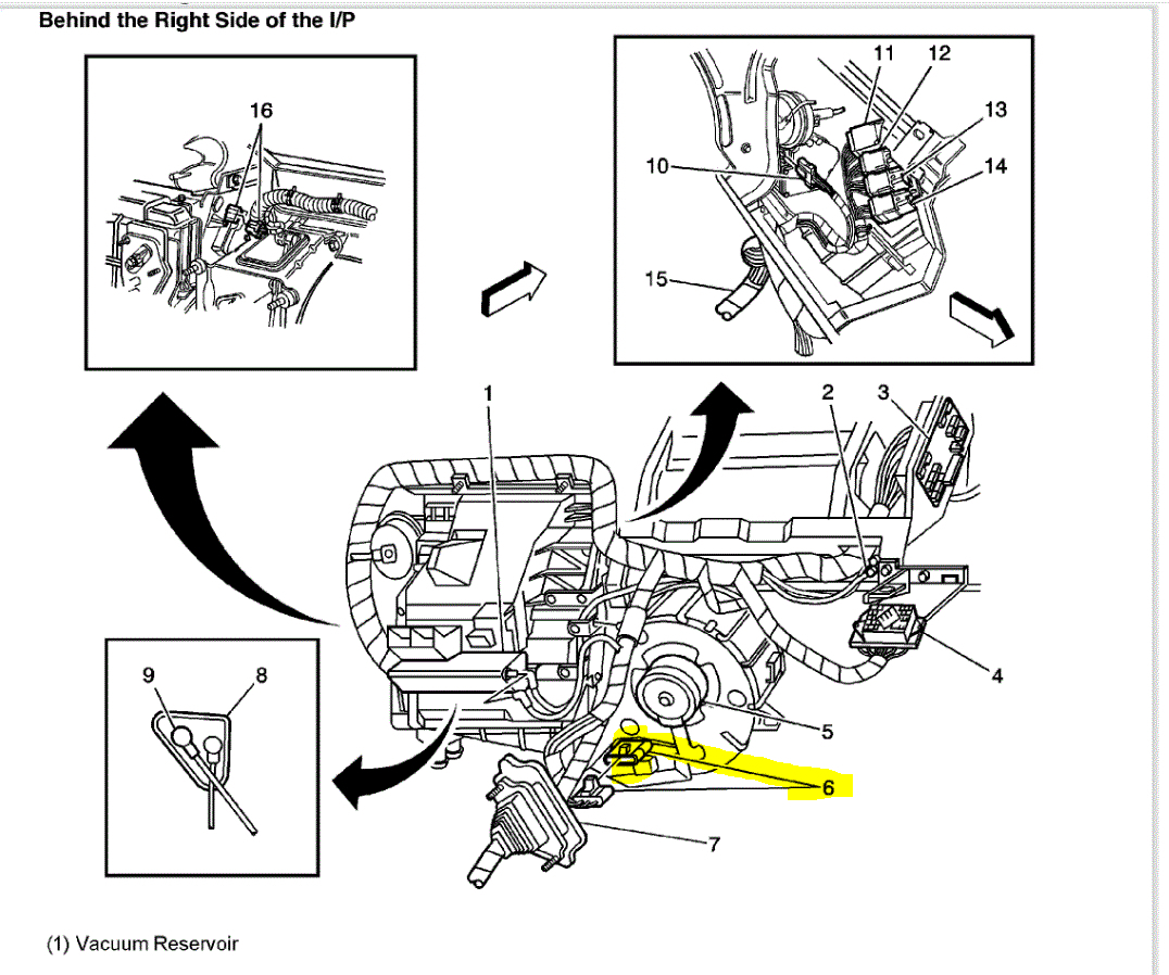

Do you mean the blower motor only worked on high? If that is the case, the blower motor resistor is faulty.
I attached a pic below showing its location. If I understood correctly, the fan only worked on high and then stopped, this is the likely suspect.
Let me know if this helps.
See pic below.
