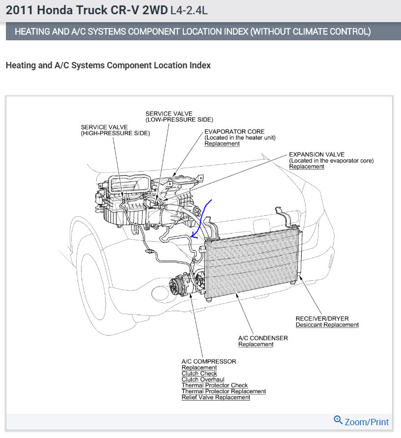

Location of AC drain hole
2011 HONDA CRV
15,000 MILES
EDO AJ
Water leaking inside car, comes out from foot compartment below dashboard.
I know that problem is because EVAP waste stuck inside AC drain hose.
What I want to know, where is exactly location (if you have got pictures will be more helpful) AC drain pipe?
Aug 22, 2018 at 8:04 AM
  • 54,837 POSTS
The evaporator water drain is on the passengers side down low on the firewall a little toward the center. Look for a rubber hose open at the end here is a picture of the hose below.
