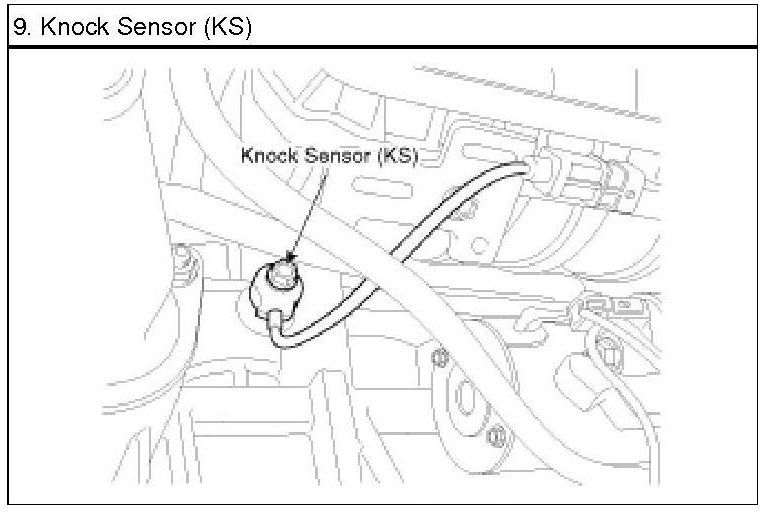

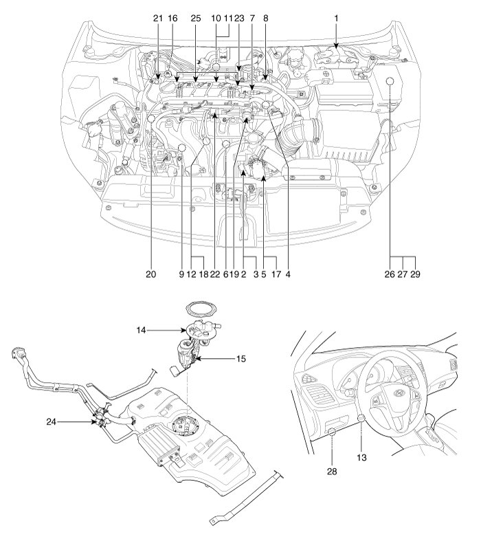

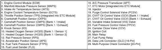

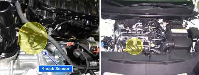

I need to know how to change the bank 1 knock sensor 1. Code P0326. I need the location too.
Jun 6, 2018 at 8:39 AM
  • 110,244 POSTS
Here are the directions for replacing the knock sensor:
SERVICE AND REPAIR
Removal
Turn the ignition switch OFF and disconnect the battery negative (-) cable.
Remove the intake manifold .
Disconnect the injector connector (A).
Remove the installation bolt (B), and then remove the sensor from the cylinder block.
Installation
CAUTION:
Install the component with the specified torques.
Note that internal damage may occur when the component is dropped. If the component has been dropped, inspect before installing.
Installation is reverse of removal.
Knock sensor installation bolt:
18.6 - 24.5 N.m (1.9 - 2.5 kgf.m, 13.7 - 18.1 lb-ft)
