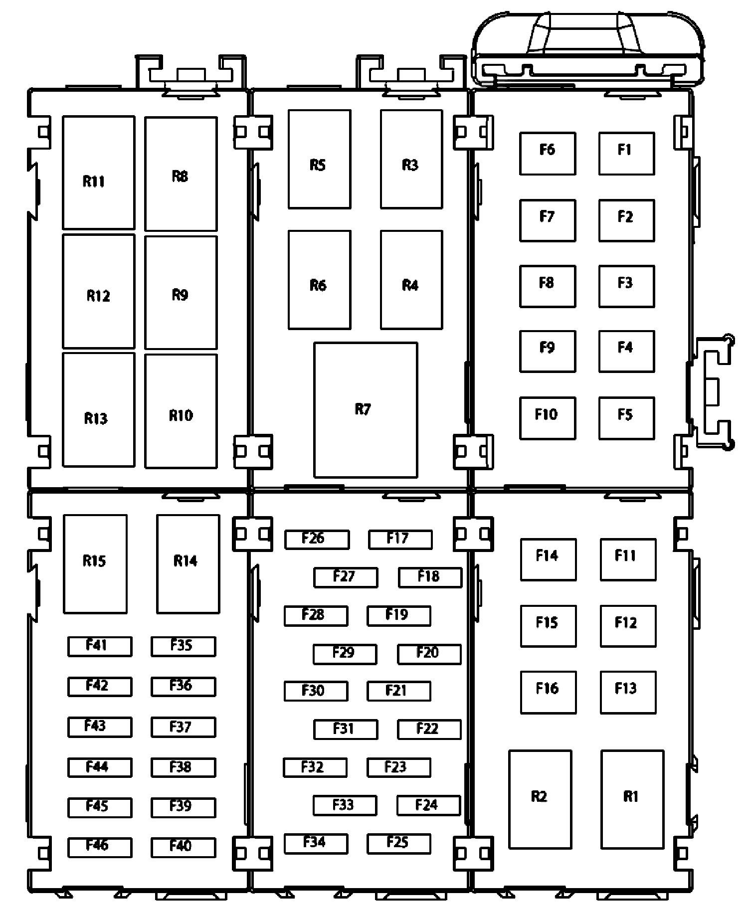

Coolant fan not running. Fuse appears to be missing. Can you confirm?

It is #3 in the engine compartment fuse box below
Image (Click to make bigger)
