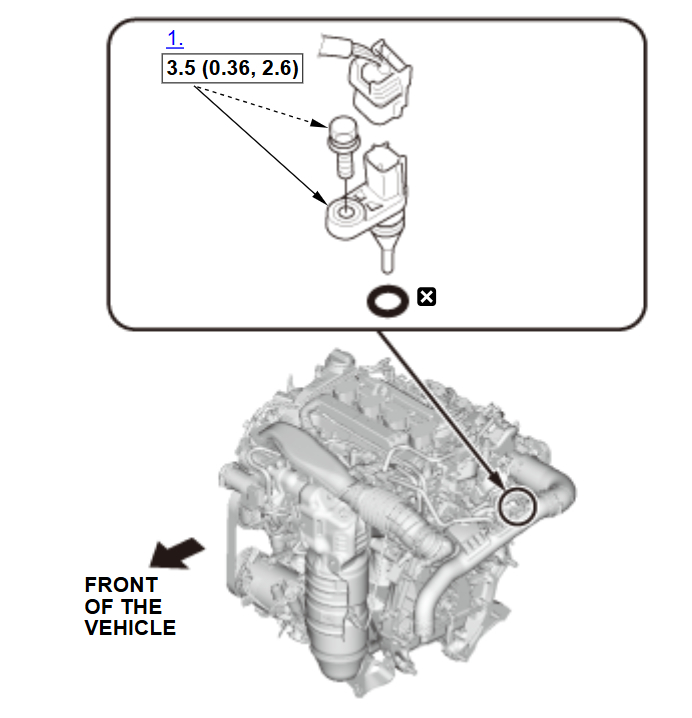

Thought it was in the radiator did not see it from above and when I took the plastic undercover off didn’t see it.

You mean for the engine computer correct? the ambient air temperature sensor is in the air intake tube for the engine. Check out the images (below). Let me know how it goes

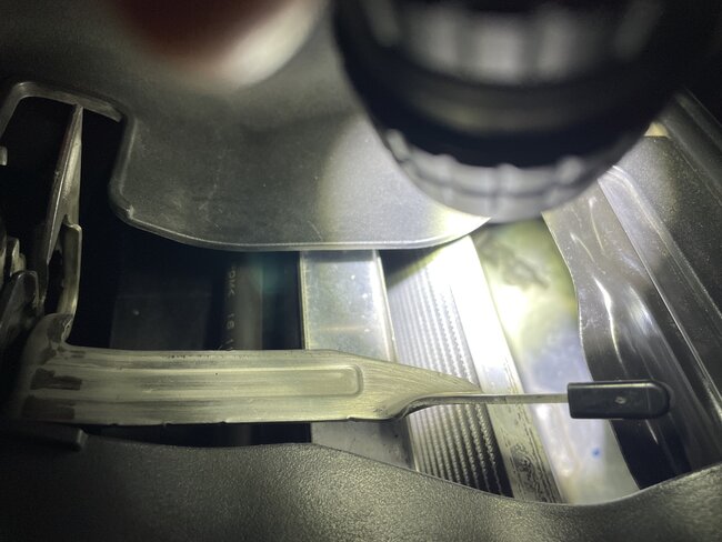

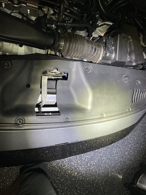

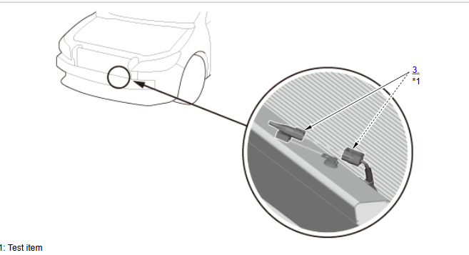

The sensor I have is for the replacement that’s on or near the driver side bumper on top of the radiator the smaller in front of the bigger radiator. Which route would be best to get to that?
Jul 26, 2026 at 10:44 AM
AZDANNO04
  • 378 POSTS
I took some pictures
Jul 26, 2026 at 10:46 AM

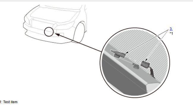

  • 55,732 POSTS

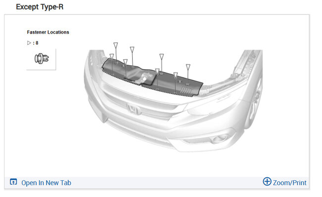

So you need the location for the HVAC system reference which is called the outside air temperature sensor. here ya go. You might need to get to it from under the car. Thanks for the images they help.
Jul 26, 2026 at 10:54 AM
AZDANNO04
  • 378 POSTS
By anychance is there any steps? I don’t want to remove pieces that I don’t know? Thank you.
Jul 26, 2026 at 11:11 AM

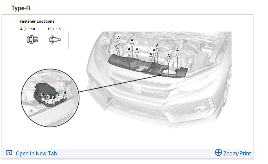

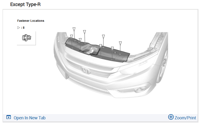

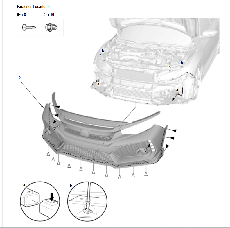

  • 55,732 POSTS
Hmm bummer, it looks like you need to remove the top valance and maybe the bumper.
1. Front Grille Cover - Remove
2. Front Bumper - Remove
Let me know hat happens.
