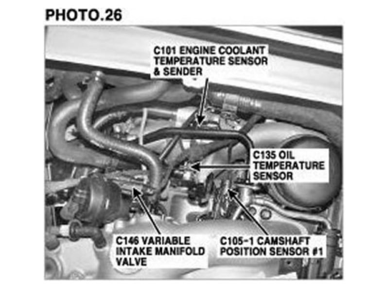

I have a P0018 code. I would like to know where the camshaft position sensor is located on my van bank 2 sensor A?
Aug 29, 2018 at 11:48 PM

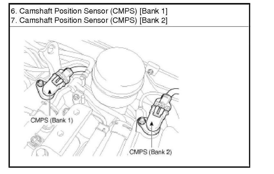

Good morning. I attached a picture of the location of both cam sensors for you to view.
Do you have codes that pointed you to the sensor?

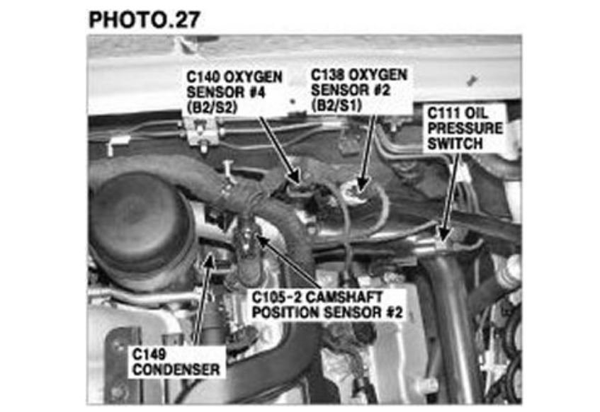

Are they mounted on the heads and are they the same as the crank position sensors? The ones you showed me have three wires. Is bank 2 near the oil canister?
Aug 30, 2018 at 1:07 AM
Yes, cam 2 is by the oil filter as in the picture. It is a three wire sensor.
No, it is not the same as a crank sensor.

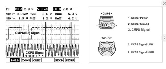

P0018
Component Inspection
1. CMPS, CKPS Inspection
(1)IG "OFF" and connect scantool.
(2)ENG "ON" and Measure signal waveform at terminal 3 of CMPS.
(3)Measure signal waveform at terminal 1 or 2 of CKPS.
A. Specification : 17th signal of the CKPS after missing tooth is aligned with the high signal of the CMPS at idle, ECM recognizes that Synchronization between CKPS and CMPS is completed.

(4)Is the measured signal waveform O.K?
YES
1) Fault is intermittent. Drive the vehicle to meet the enable condition for the DTC. and go to "Verification of Vehicle Repair" procedure.
NO
1) Go to "Timing Mark Inspection" procedure as follow.
