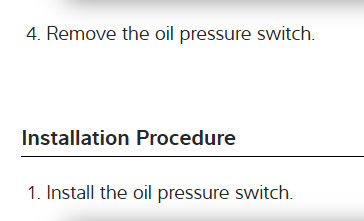

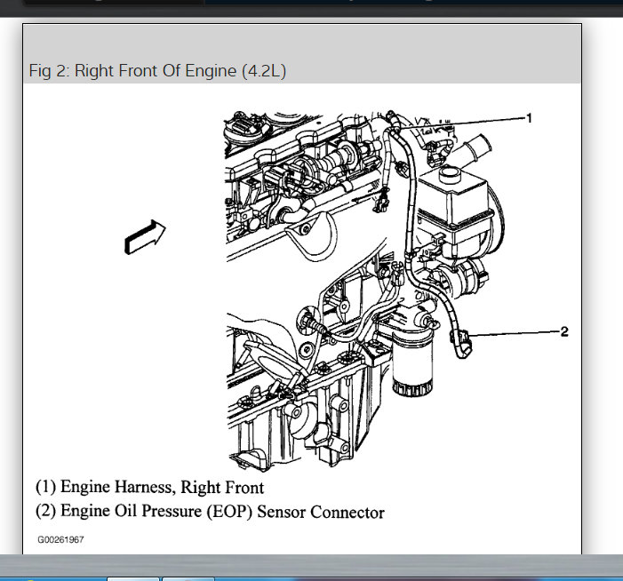

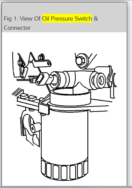

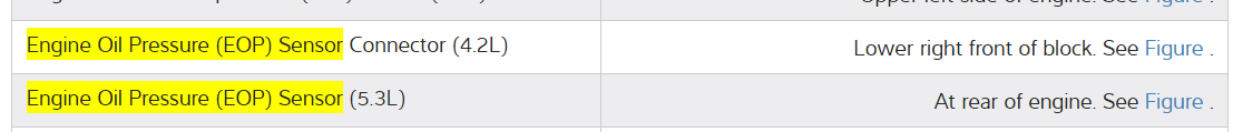

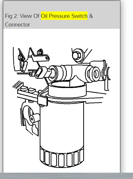

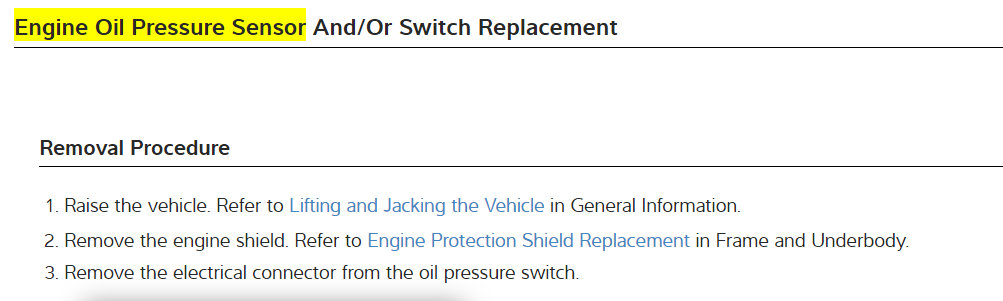

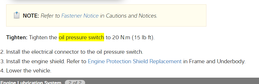

I'm changing my oil pressure switch and don't know the location and the exact tools I'll be needing. Looked on YouTube and found same year but truck or other models. Just wanting to get right location for year. I know I'll need a special socket just need size and anything else I may need. Thank you.
Apr 13, 2019 at 11:47 PM
SCGRANTURISMO
  • 4,897 POSTS
I have included the information that you requested in the diagrams down below. As far as a special tool, I have always used a pair of channel lock pliers to get at mine. Please go through the information and get back to us with how it turns out, please.
