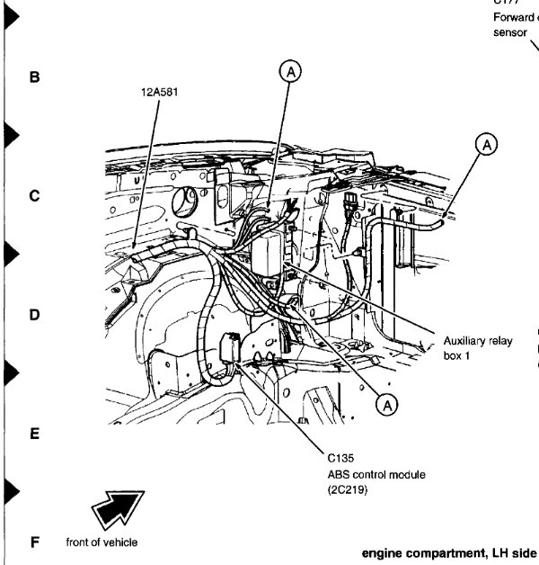

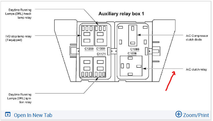

A/C is not working, warm air. A/C clutch wheel is not spinning. Where do I find the A/C clutch relay to check it?

Here is the A/C clutch relay as requested, the relay is located in the #1 relay box under the hood. Check out the images (below). Please let us know what happens.

Thank you, Ken. The refrigerant is okay, but I have a problem finding the box with the A/C clutch relay. Where in the motor compartment is this auxiliary relay box?

It is on the left side of the engine compartment. Check out the images (below).

Thanks again Ken. I found it under the air tubes, and it is not clicking.

Does the other functions of the HVAC system work? If so, I would bypass the low side pressure switch to see if the compressor clicks on, the location of the switch is on the low side AC line, it should have two wires, jump them together with the system on and the engine running. Also, have you checked the fuses for the compressor which is the fuse # f33 in the fuse panel on the right kick panel. Please let me know.
