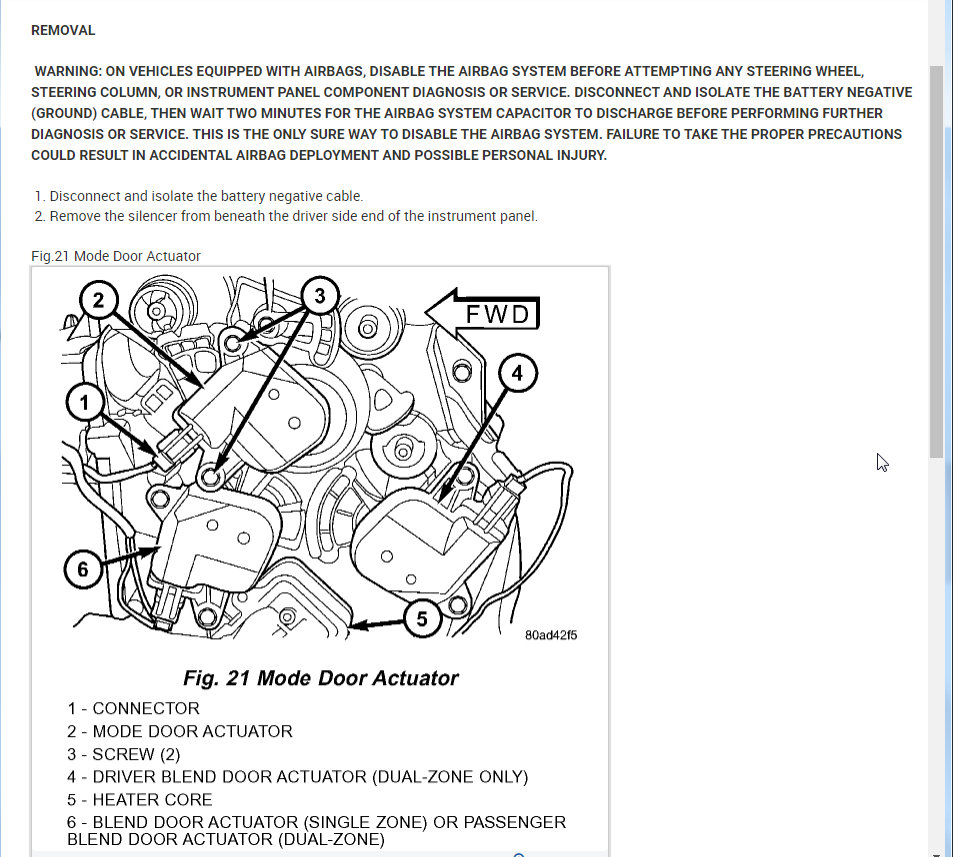

Where is the actuator for the vent control located stuck on defrost?
Dec 11, 2020 at 5:50 AM

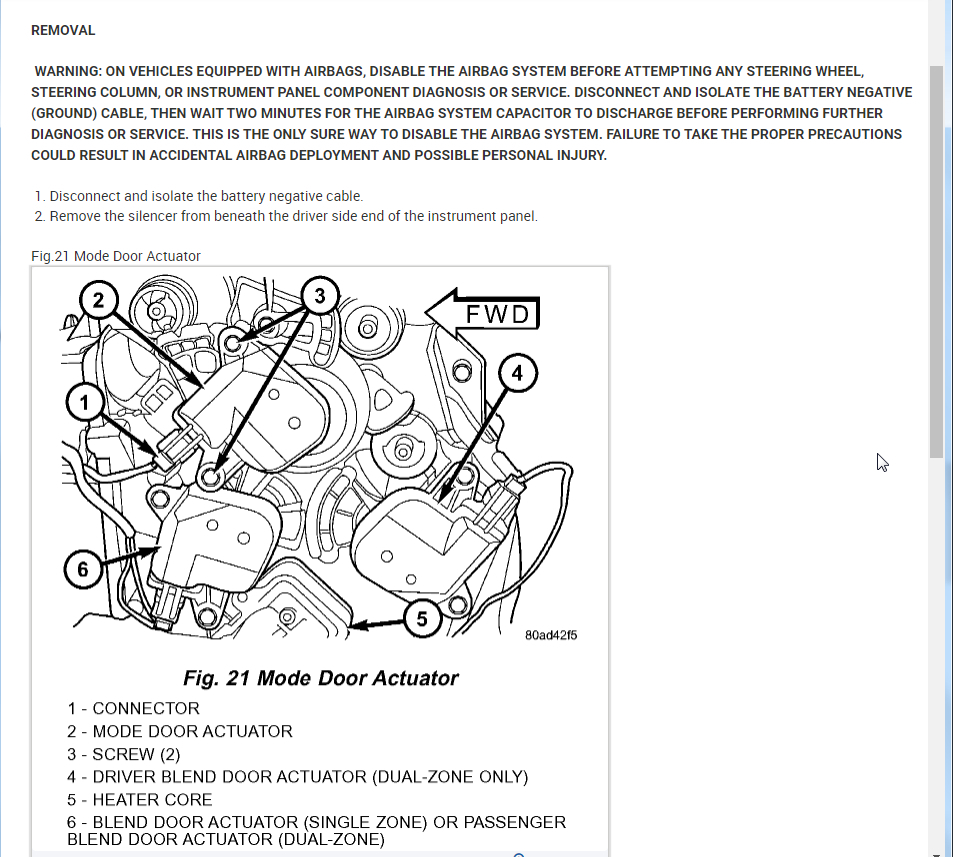

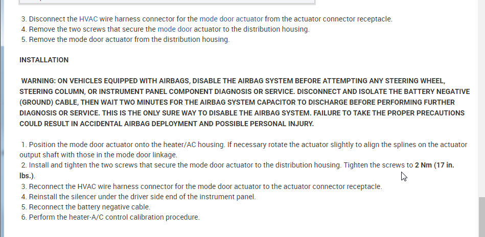

Here is a guide that talks about this issue:
https://www.2carpros.com/articles/air-vents-stay-in-the-defrost-position
I am attaching the process on how to replace the mode door actuator. Run through this and let me know what questions you have. Thanks
Dec 11, 2020 at 10:37 AM
OGWAYNE

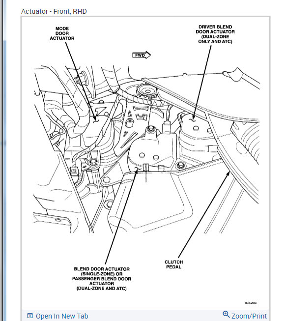

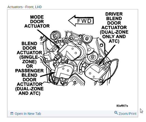

My problem is there are 4 actuators 3 on the passenger side 1 on the drivers side. which one operates the vents the mode or blend? also the temperature wouldn’t change.
Dec 12, 2020 at 9:26 AM
Please see the attached document below. It shows the 3 actuators and the mode door is on the top. The blend doors (assuming you have dual zone) are below those. If the temperature won't change either then you have an issue with those as well. So you may just want to change them all. Please see the attachments on my previous post for more detail on this.
