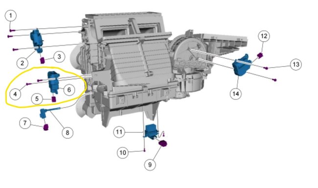

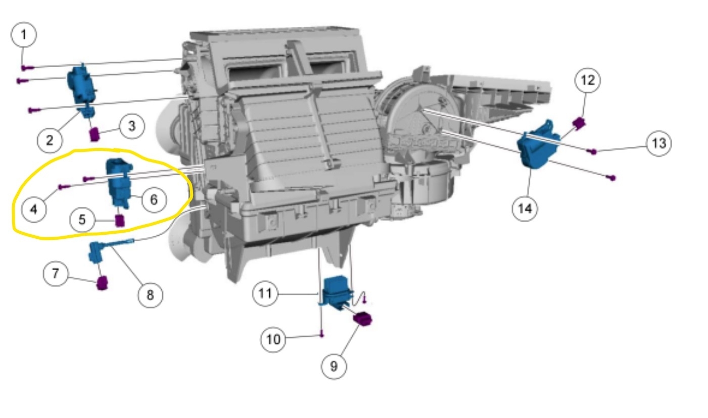

where is the driver's side blend door located?
2015 FORD EXPLORER
200,000 MILES • 3.5L • 6 CYL • 4WD • AUTOMATIC
TIMOTHYPM
Drivers side blend door needs replaced. Trying to get labor time and location.
Feb 16, 2025 at 5:01 AM
STEVE W.
  • 15,351 POSTS
That is one of the few easy ones out there. Drop the left side under dash trim panel. Look up on the side of the HVAC case and you can see two actuators. The lower one is the blend door. Disconnect the connector and remove the 2 screws. Reverse the process to install the new one. It takes about a half hour to do.
