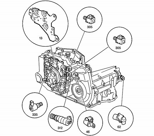

I need to find out where the input and output transmission speed sensors are.

See the attached picture for locations. Number 46 is the input and number 62 is the output sensor. Hope it helps.

Thank you, this will help.
