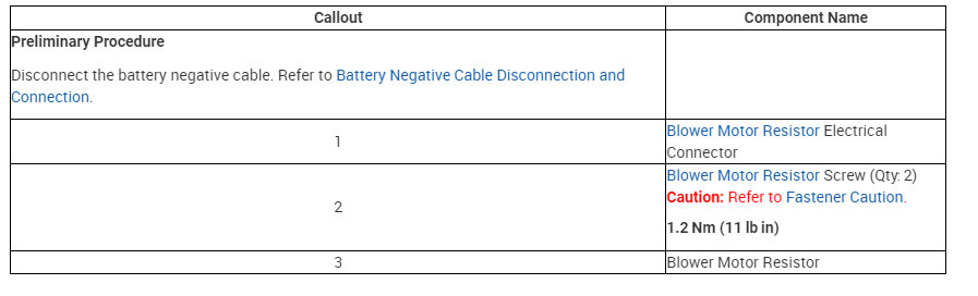

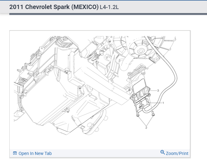

I am trying to locate the blower fan Rheostat resistor, the fan speed selector only working on full blow, I managed to change the blower motor fan. I just need the location for the resistor.

The blower motor resistor is right near the blower motor. You can't see it because it slides into the HVAC box.
If you look below, I attached the directions for replacing it. In the first pic, it shows the location. In pic 2, the extremely vague directions are provided. (LOL). It is straight forward, and you shouldn't have any trouble.

Thank you JACOBANDNICKOLAS for your help , this was a great help, at the beginning when I researched it , it showed me the wrong part even though it was described for my cars with all details, because it was the wrong shape I never thought that was the resistor I am looking for, now its confirmed by you, I have found the part I am looking for. many thanks

Hello , great help thank you so much, I managed to buy the resistor and fit it myself, very easy to install, funny side is the part I had fitted is actually belongs to Isuzu vehicle, which is identical to the Chevrolet Spark, it's working perfectly and was also half the price. many thanks.
