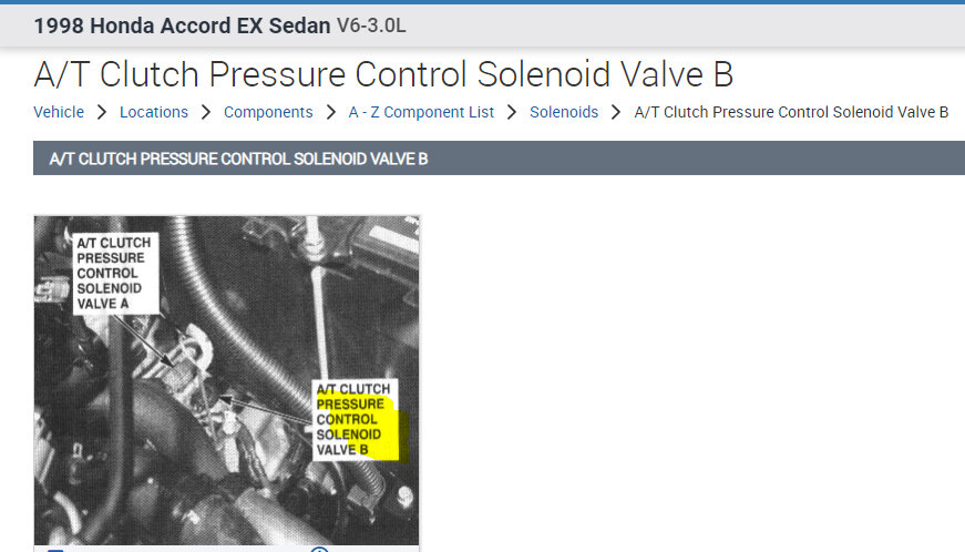

I got a p0758 shift solenoid "B" electrical reading today where is that solenoid located at I can't seem to locate it thank you in advance.

I attached a pic of the solenoid below. The manual indicates the left side of the engine compartment, but I believe that is from the driver's seat. When you open the hood, it should be on the right.
Take a look and let me know if this helps.
See pic below.
