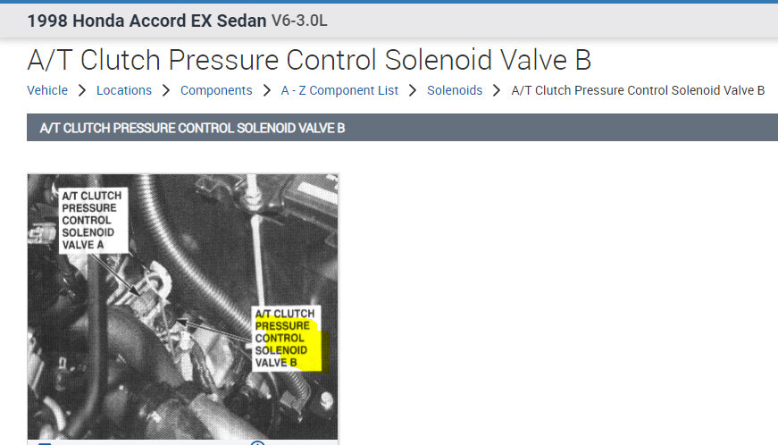

Code p0758, where is the shift solenoid "B" located?
1998 HONDA ACCORD
288,158 MILES • 3.0L • V6 • 2WD • AUTOMATIC

I got a p0758 shift solenoid "B" electrical reading today where is that solenoid located at I can't seem to locate it thank you in advance.

I attached a pic of the solenoid below. The manual indicates the left side of the engine compartment, but I believe that is from the driver's seat. When you open the hood, it should be on the right.
Take a look and let me know if this helps.
See pic below.
