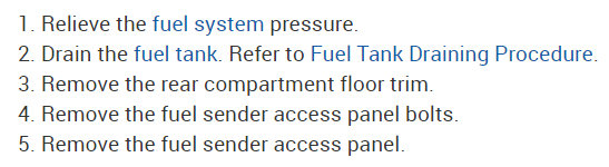

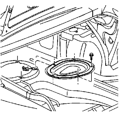

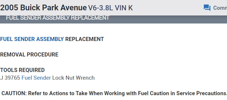

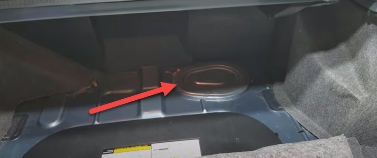

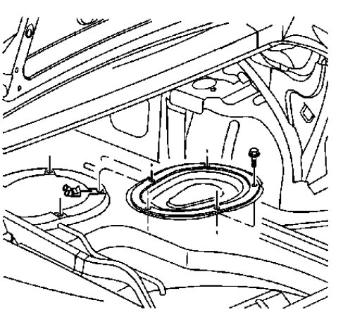

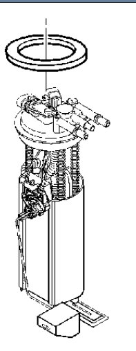

Where is fuel pump located?

It's under an access panel in the trunk. I have attached a picture Check out the diagrams (below). Please let us know what happens.

Hello, I'm Danny.

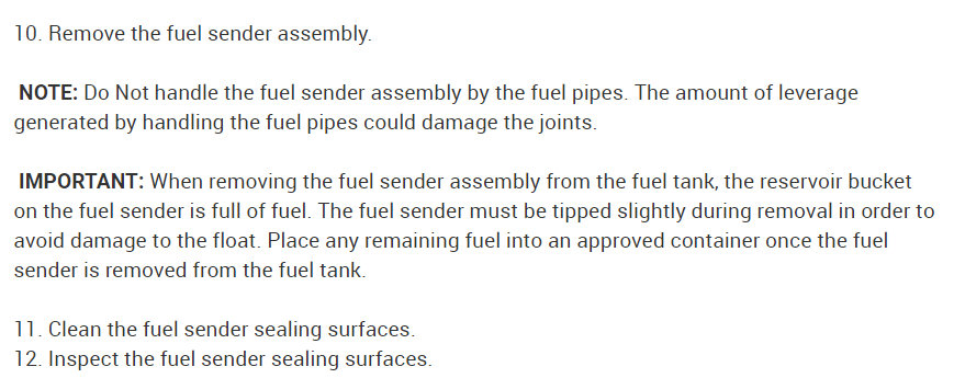

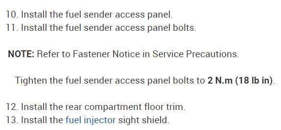

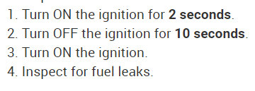

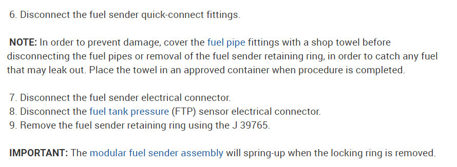

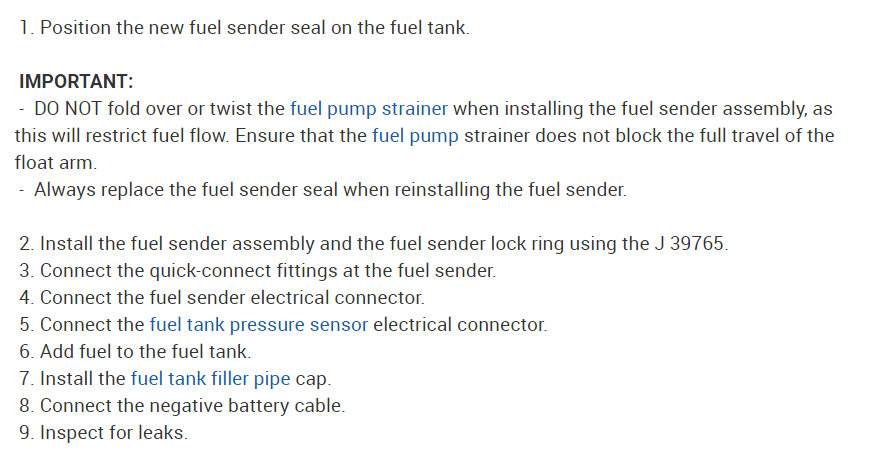

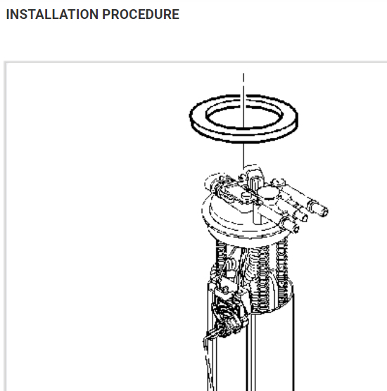

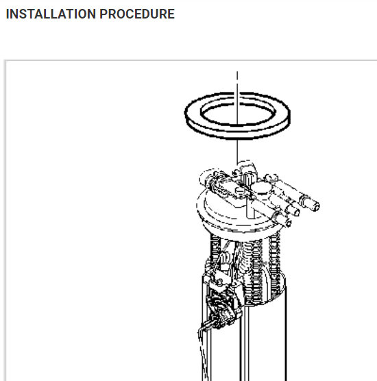

Just to jump in here, if you or someone you know is confident in doing the repair yourselves here is some information. Here is a tutorial showing what is involved in replacing an in-tank fuel pump:
https://www.2carpros.com/articles/how-to-replace-an-electric-fuel-pump
Luckily, you will not have to remove the gas tank because you have an access panel. I've attached picture steps below on how to replace the fuel pump on your car. Hope this helps and thanks for using 2CarPros.
