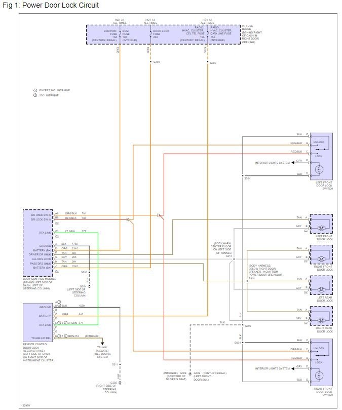

Need to know where location of key-less entry receiver is located on a 2000 to 2001 car listed above.

The 2000 Remote (key-less) Control Door Lock Receiver (RCDLR) is located Left side of dash, on right side of instrument cluster.
2001 as well.
Removal and Installation
Turn ignition switch to "off" position. Remove instrument panel upper trim. Release retaining tabs from Remote Control Door Lock Receiver (RCDLR). Remove RCDLR. Disconnect harness connector. To install, reverse removal procedure. Reprogram transmitter(s). See transmitter programming under programming.
Here is the wiring diagram, too.
