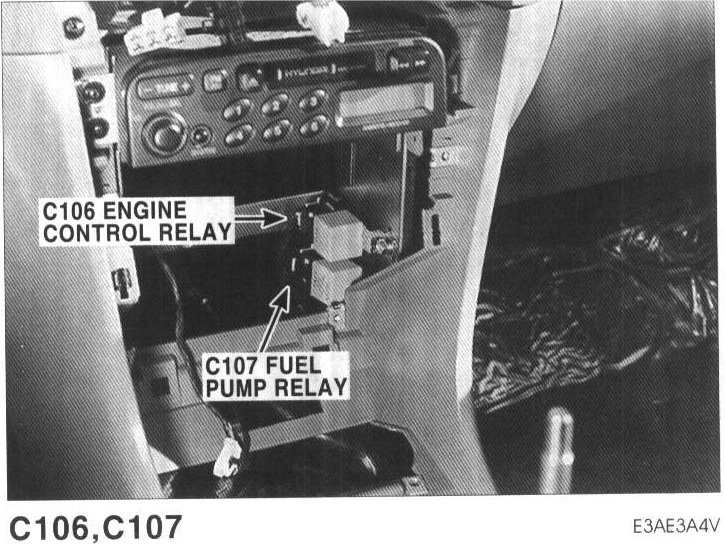

Intermittent fuel to rail sometimes will start sometimes not.

Pic 1 shows the fuel pump relay.That is the only relay related to fuel supply. Here is a link that explains how to test a relay:
You will need a volt or multi meter. Here are a few links you may find helpful:
https://www.2carpros.com/articles
Let me know if that helps.

I will let you know. Thank you for that, I very much appreciate that information.

Will do, those checked out, Think I will replace the fuel pump, and filter, when I get a few bucks.
