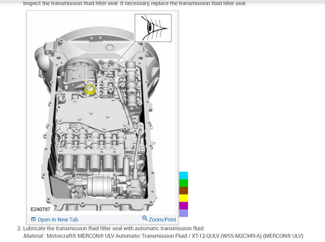

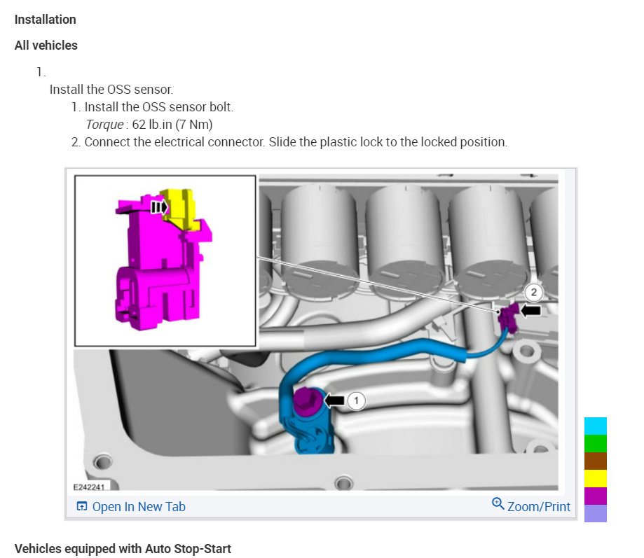

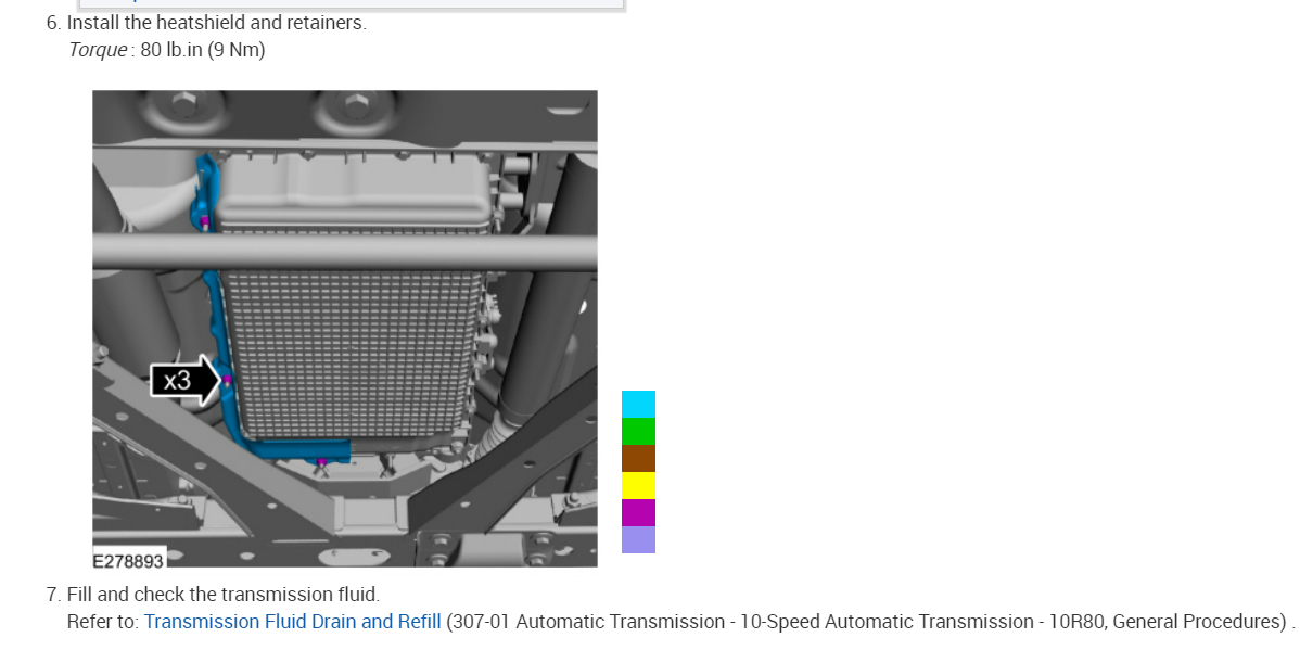

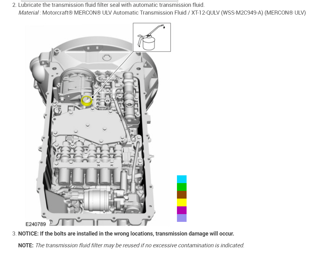

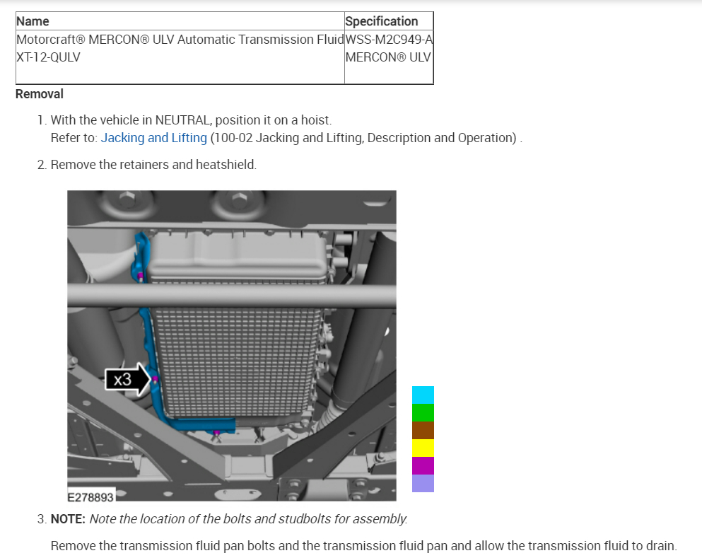

Code p0500, where is the VSS located?
2017 FORD RANGER
62,000 MILES • 3.2L • 5 CYL • TURBO • 4WD • MANUAL
LEO.2017

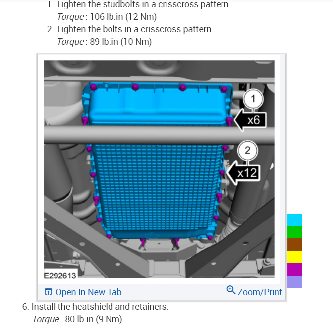

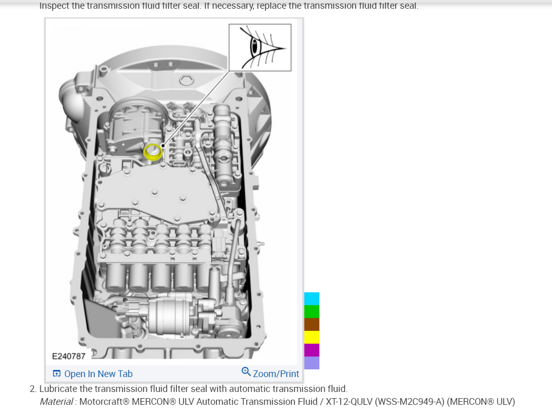

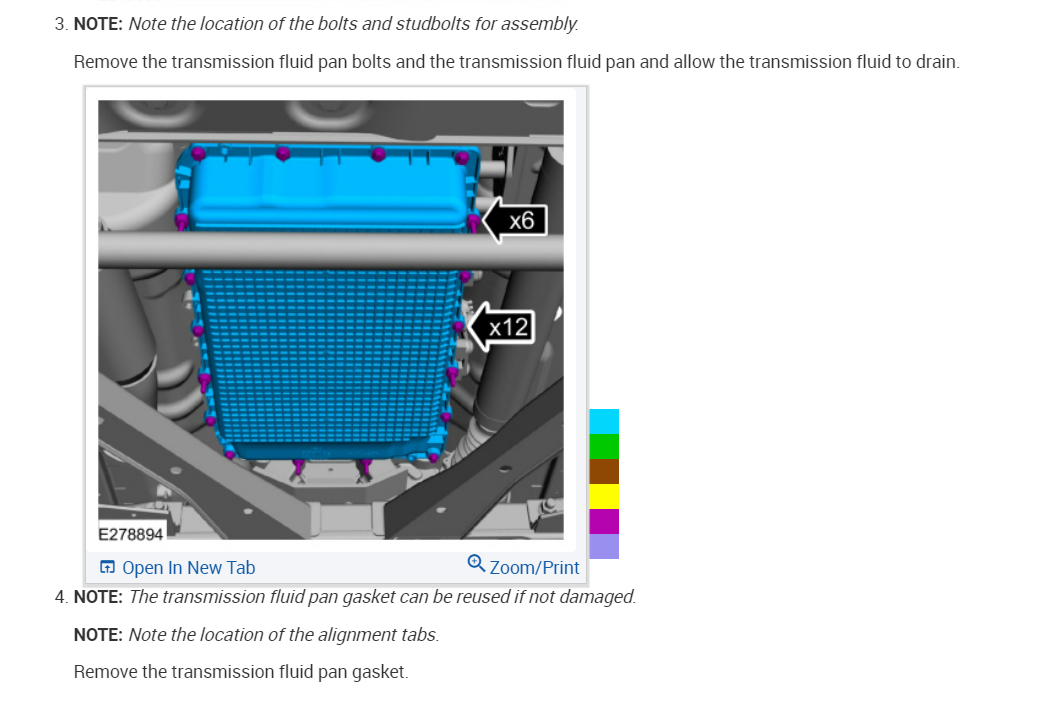

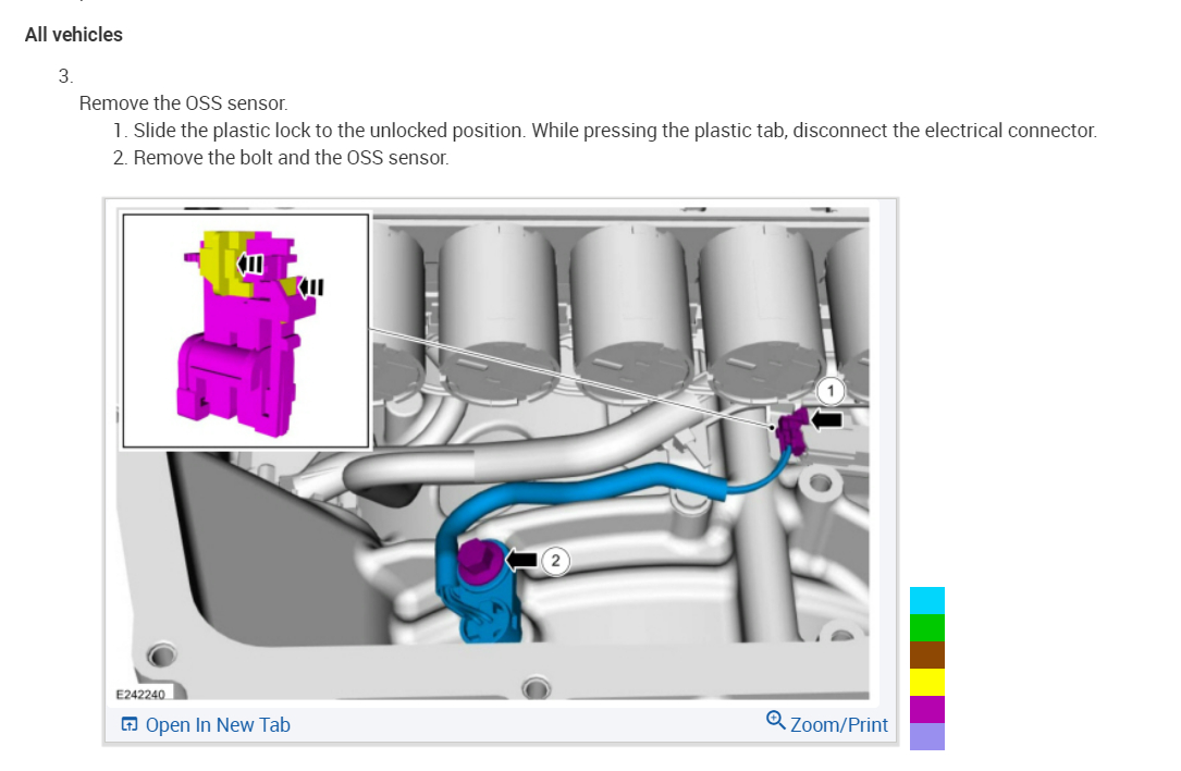

Hello friends, I have problems with the VSS of my truck, when scanning it gives me code p0500. If you can help me identify that sensor to be able to check it, I would be very grateful.
Jul 13, 2022 at 2:57 PM
  • 55,224 POSTS

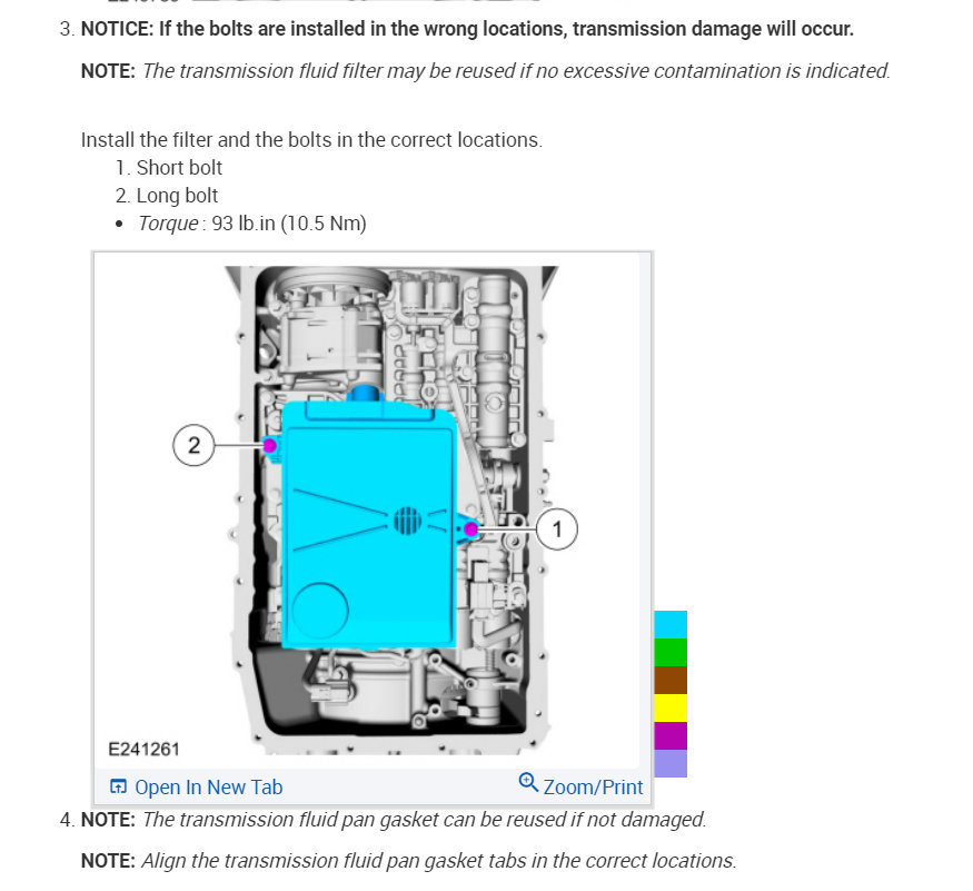

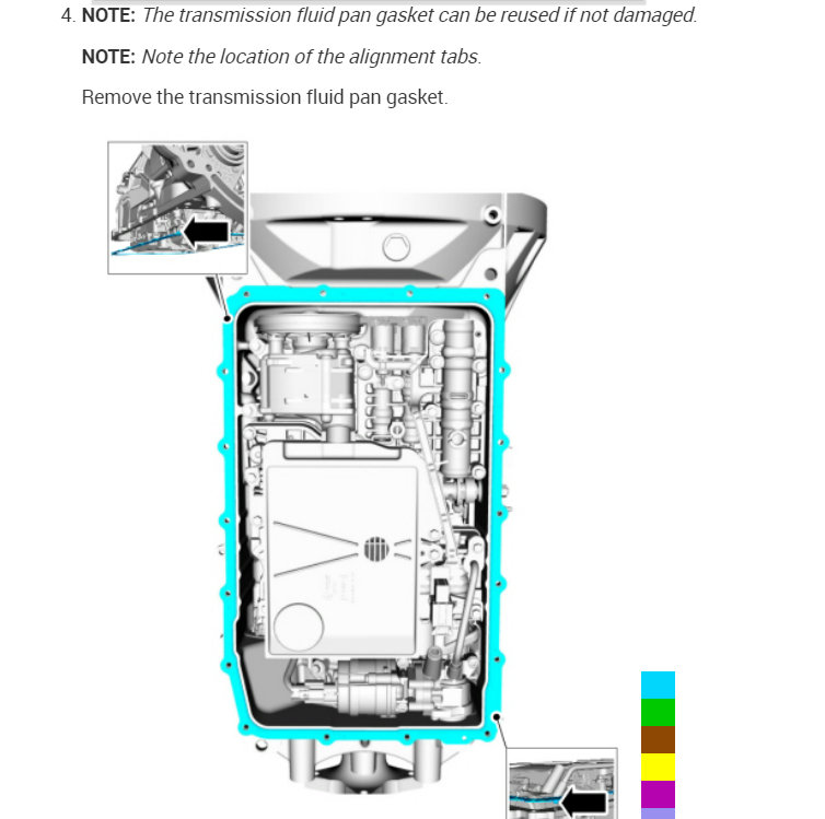

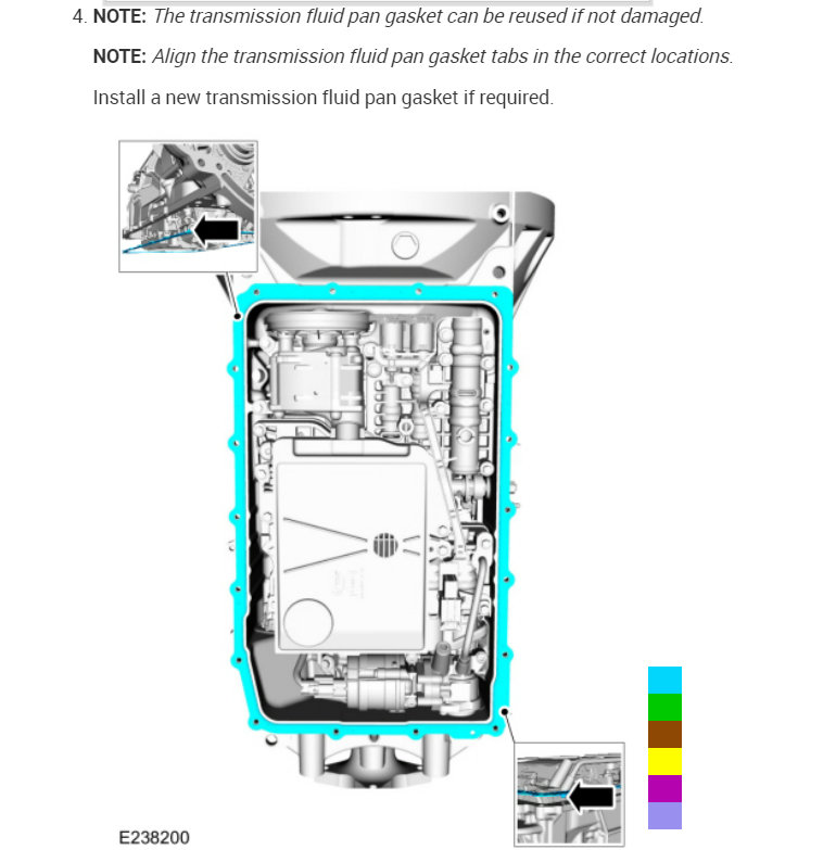

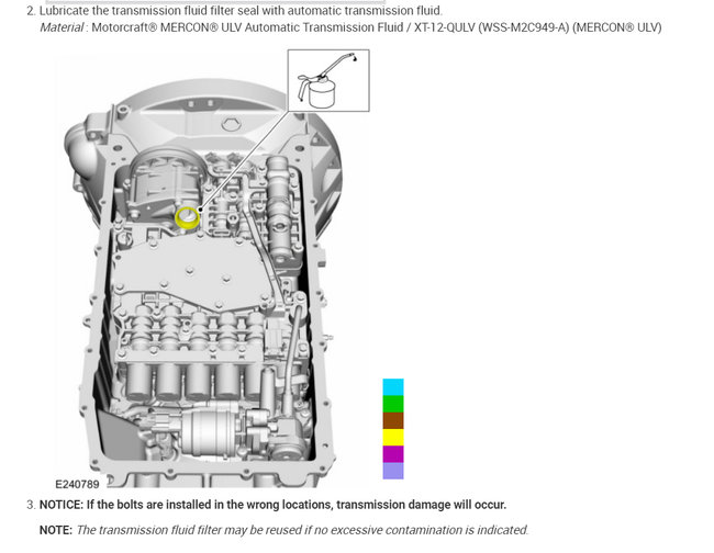

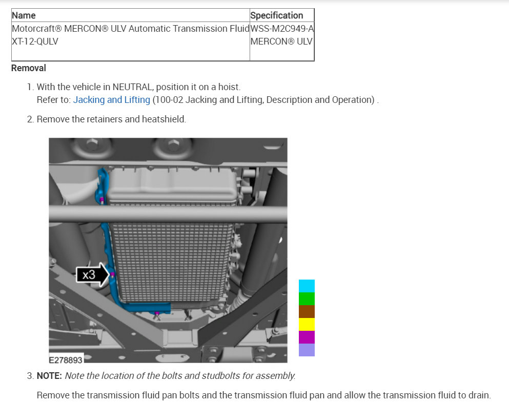

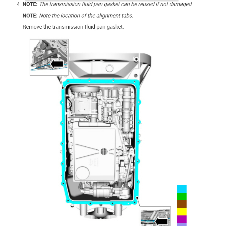

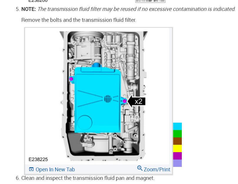

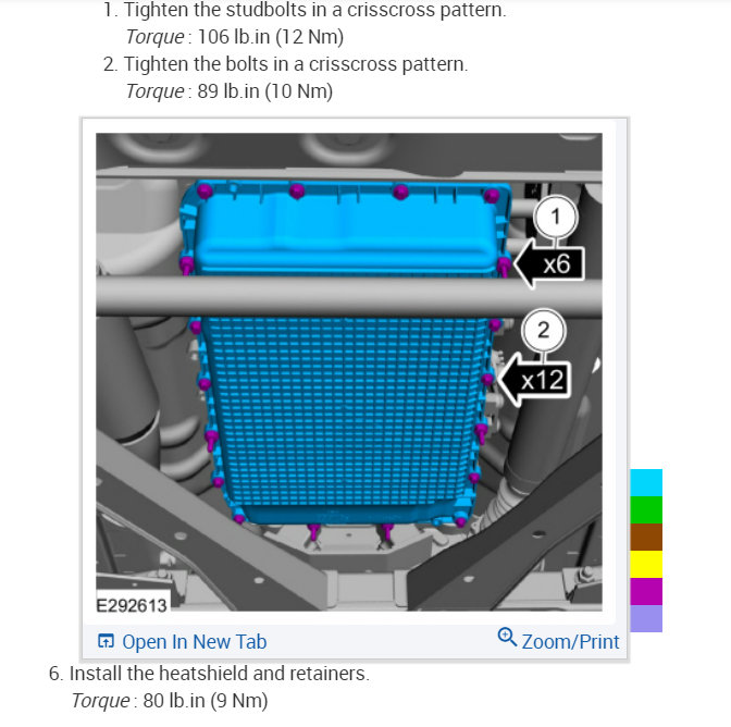

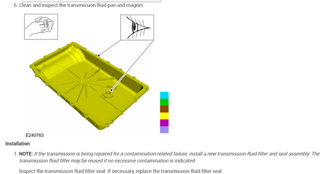

It looks like the vehicle speed sensor is inside the transmission, you will need to remove the transmission pan which I have given instructions for in the diagrams below. You can see the VSS is positioned next to the shift solenoids with a wiring connector that must be removed before taking the sensor out. Check out the diagrams (below). Please let us know if you need anything else to get the problem fixed.
