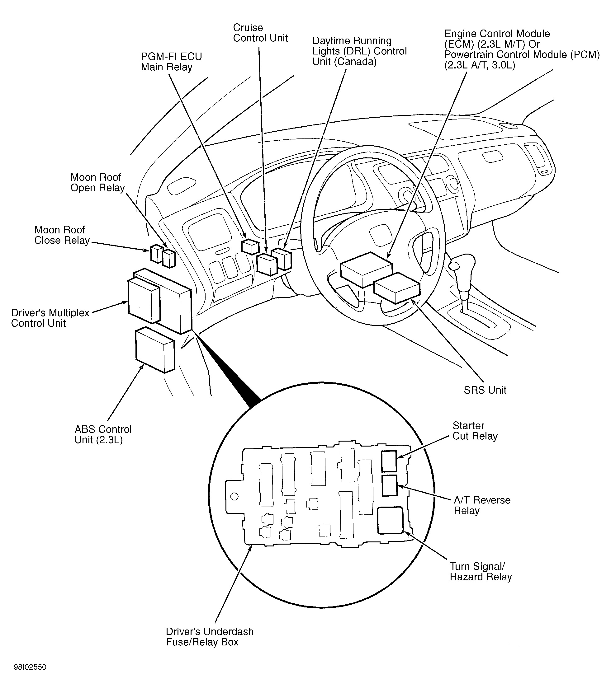

I have watched many videos on YouTube for the location and for some reason my unit is not located under the carpet on the passenger side. Is there any other location I should be looking for this? Thanks for your help.

In front of the center console where it is sufficiently difficult to get to.
