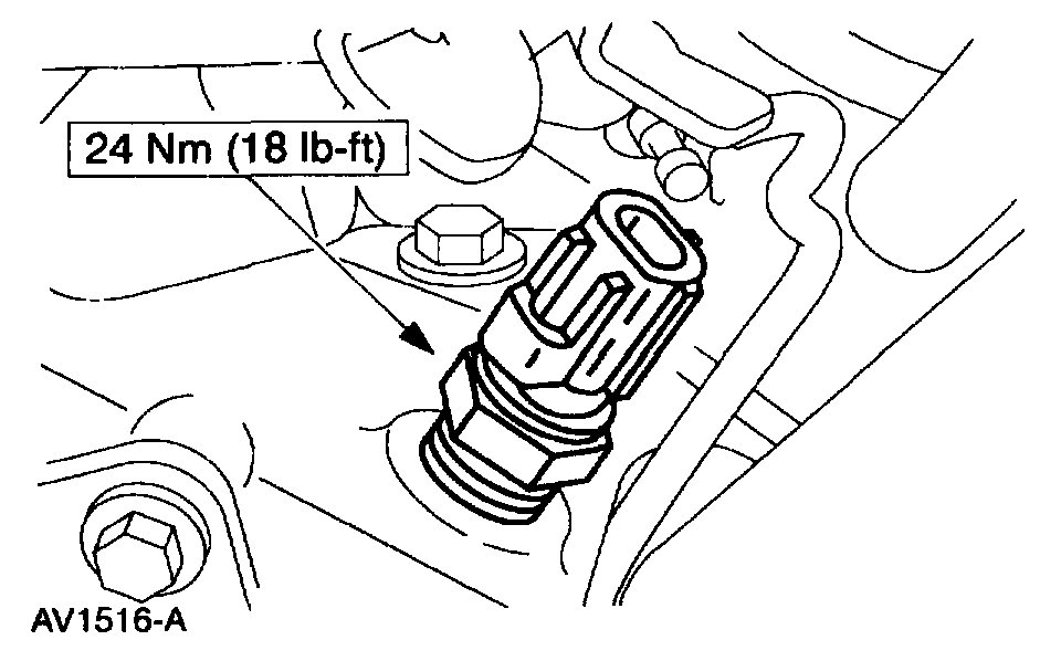

Locating the ECT (engine coolant temperature sending unit)
2002 FORD WINDSTAR
126,000 MILES • 3.0L • V6 • 2WD • AUTOMATIC
JOSé LUIS DE LEóN YáñEZ
I would love to hear from you guys where the heck is that sending unit located. It seems it is the one to blame because my mini van has a very poor idle speed and high fuel consumption. I have the engine light on. Thanks.

You listed this as a 3.0L but I am only showing a 3.8. If that is not correct, let me know.
Here are two links you may find of interest. The first discusses symptoms of a bad sensor. The second shows how in general to replace one.
https://www.2carpros.com/articles/symptoms-of-a-bad-coolant-temperature-sensor
https://www.2carpros.com/articles/coolant-temperature-sensor-cts-replacement

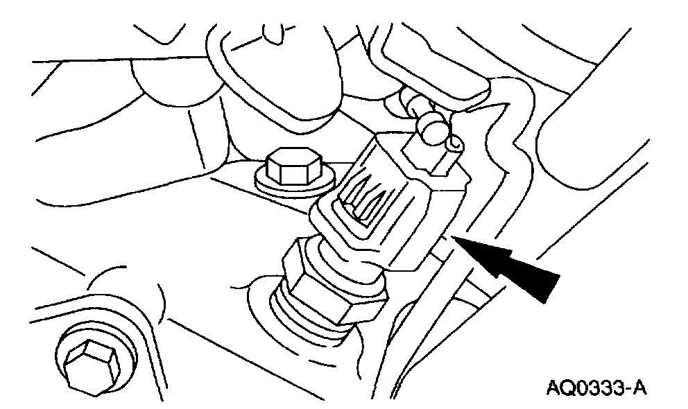

The sensor is located on the front portion top section of the engine. Here are the directions specific to your vehicle for replacement and the two attached pictures correlate with these directions:
________________________
REMOVAL
1. Disconnect the battery ground cable.
2. Partially drain the cooling system.
3. Disconnect the Engine Coolant Temperature (ECT) sensor electrical connector.
4. Remove the ECT.
INSTALLATION
1. To install, reverse the removal procedure.
