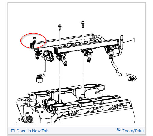

Where is valve to check fuel pump PSI?
Jul 22, 2020 at 11:54 PM
Experienced Mechanic
18,907 POSTS

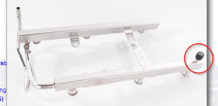

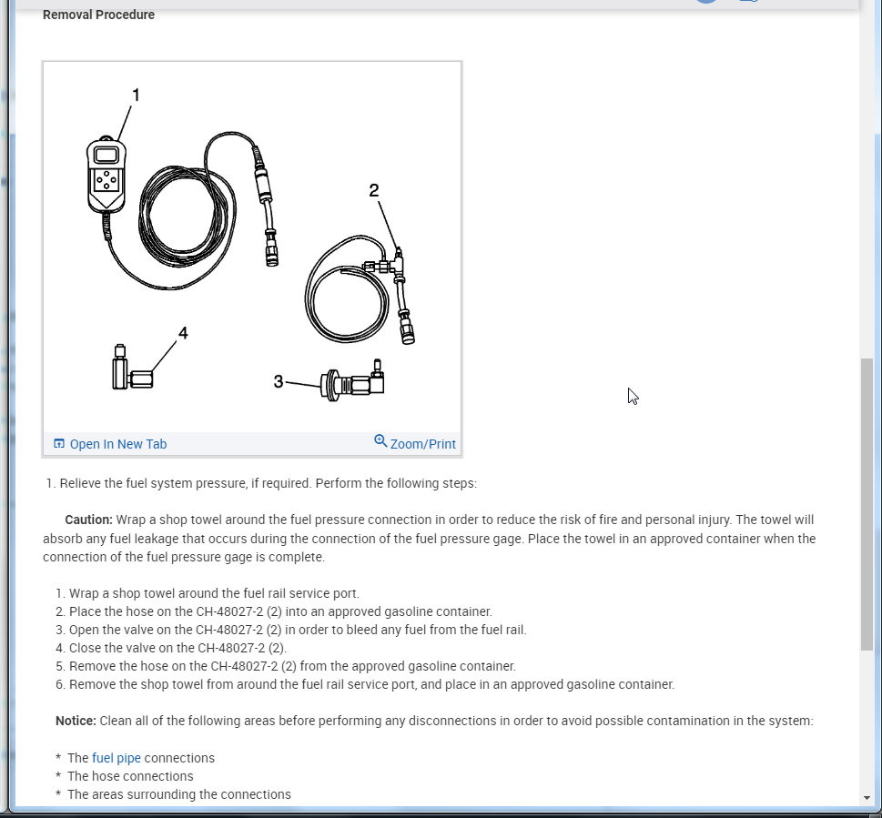

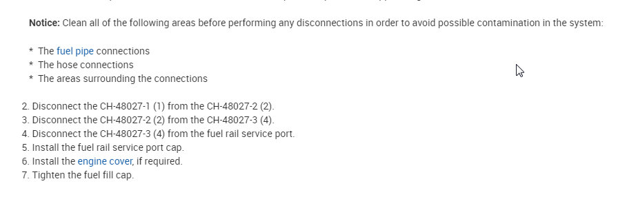

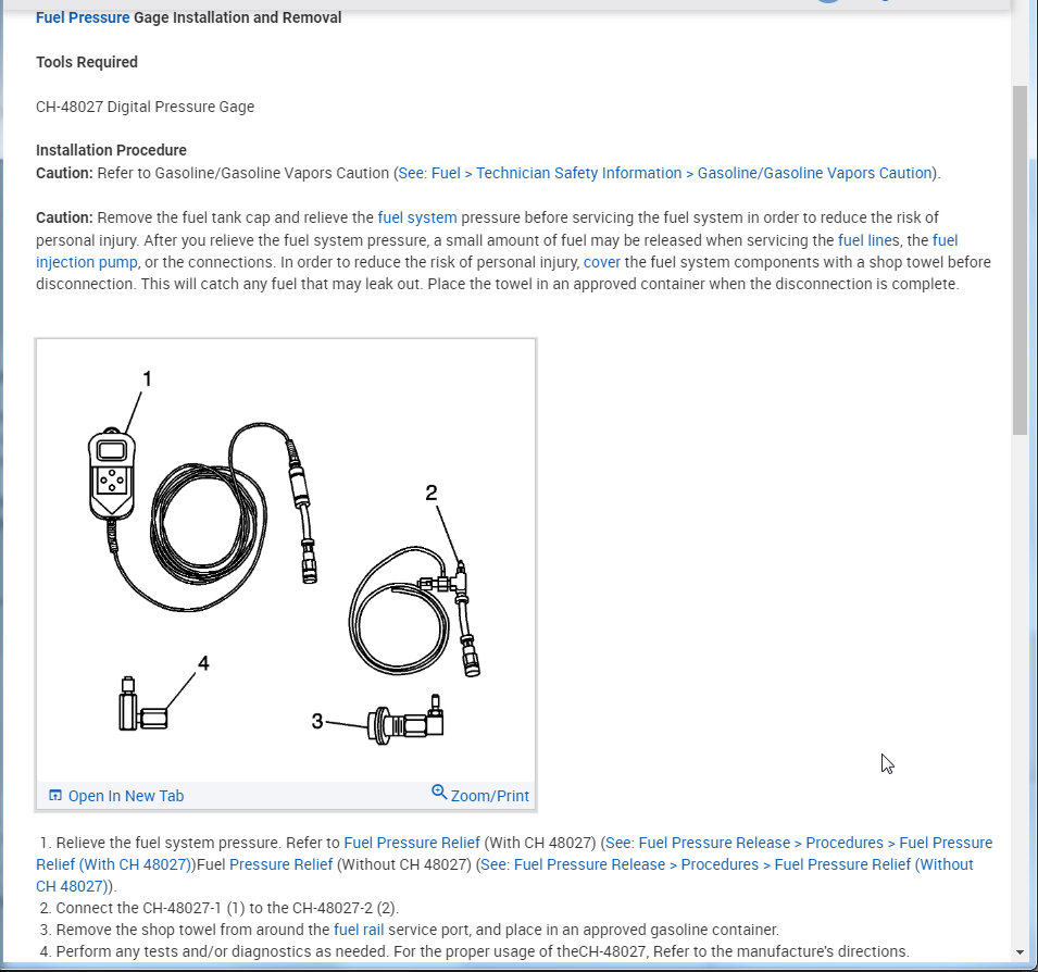

I attached the info from the manual. It should be on the fuel rail itself. Take a look at all this info and let me know if you still can't find it and we will see what more info we can dig up. Thanks
