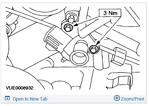

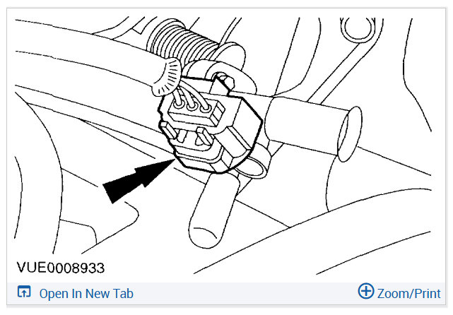

I have the error code "P0190 Fuel Rail Pressure Sensor Circuit Bank 1" but the manual I have seems to only mention the older "Fuel Pressure Regulator". Could someone provide me with the updated diagrams and instructions for locating and replacing the Fuel Rail Pressure Sensor?
Jun 8, 2025 at 7:39 AM
  • 55,421 POSTS
It says the sensor is on the top left rear of the engine which should be on or near the fuel rail. This is what it looks like. Check out the images (below). Let us know if you need anything else.

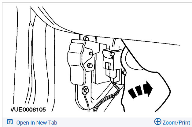

So the engine begins to start and runs for as long as starter is sprayed into the intake (a few seconds). This would mean the issue is in the fuel delivery correct? If this is the issue, it's likely the fuel pump yes?
Jul 28, 2025 at 9:26 AM
  • 55,421 POSTS
Yes, but I would check the inertia switch as well which is at the right side kick panel. Check out the images (below). Please let us know what happens.
Jul 28, 2025 at 10:20 AM
AL-WITH-A-CAR
  • 11 POSTS
Okay, what does that switch perform, and where precisely is the panel located?
Jul 28, 2025 at 10:36 AM
  • 55,421 POSTS
This switch is a safety feature, it cuts power to the fuel pump when in an accident. Push the button on top of it to reset it. It is behind the right side kick panel.
Jul 29, 2025 at 3:26 AM
AL-WITH-A-CAR
  • 11 POSTS
Where exactly is that located?
Jul 29, 2025 at 9:49 AM
  • 55,421 POSTS
It is behind the right side kick panel. Have you removed the panel? The panel is on the right side footwell rear the door
