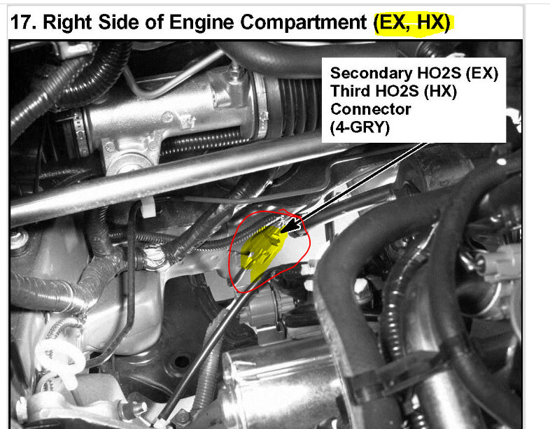

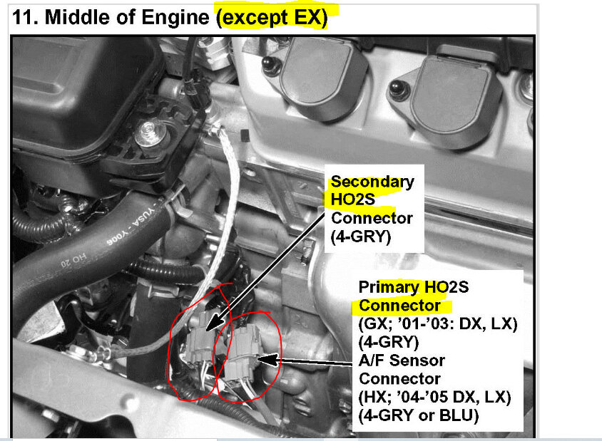

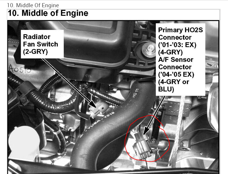

The car listed above is an EX-model. My car only have one oxygen sensor plug on it at the top where is the other, because I purchased a new exhaust manifold with the catalytic converter on it with the two plugs one on the top and one on the bottom of the exhaust manifold but I only have one plug so what would I what can I do?

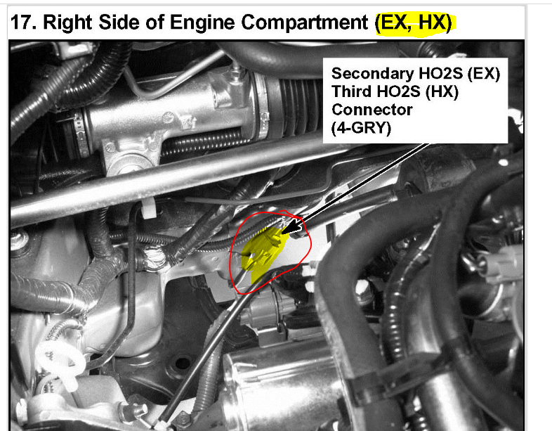

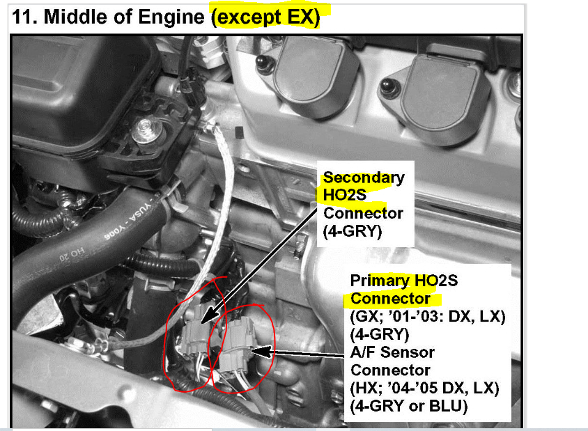

If you look below, I attached three different pictures. Note that each one provides the oxygen sensors connectors' locations.
When you look at the pics, note the model vehicle each one is for. They are in different locations for different models.
Let me know if this helps or if you have questions.
