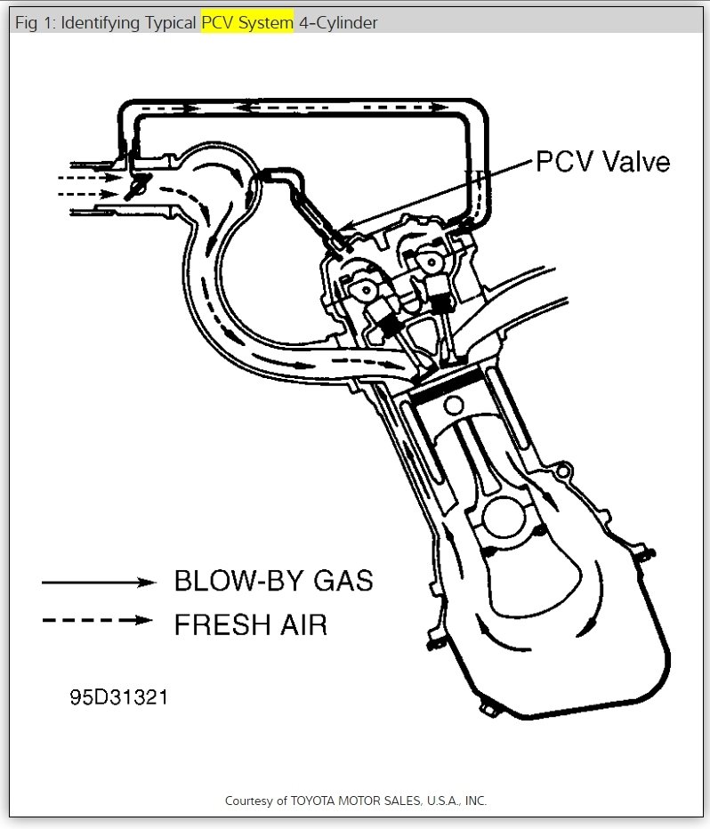

I HAVE A 1993 TOYOTA CAMRY 4CYL 2.2 5SFE ENGINE AND I CAN'T LOCATE THE PCV BREATHER VALVE DOES IT HAVE ONE I AM LEAKING SOME OIL AND WANT TO CHANGE

Hey Joe,
It looks like it is on the top of the valve cover. Check for a hose from the manifold plugged into the valve cover.
Here is a diagram of the valve for you.
