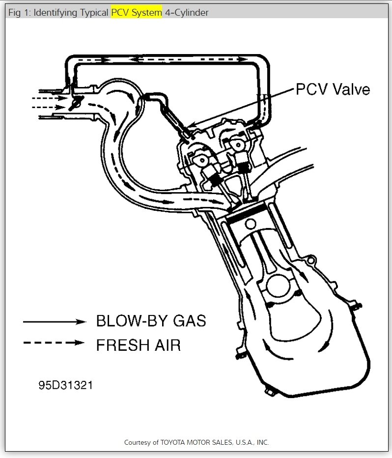

LOCATE PCV VALVE
1993 TOYOTA CAMRY
197,000 MILES
JABRAMO
  • 49 POSTS
I HAVE A 1993 TOYOTA CAMRY 4CYL 2.2 5SFE ENGINE AND I CAN'T LOCATE THE PCV BREATHER VALVE DOES IT HAVE ONE I AM LEAKING SOME OIL AND WANT TO CHANGE
THX-JOE
May 26, 2013 at 7:57 AM
  • 55,399 POSTS
Hey Joe,
It looks like it is on the top of the valve cover. Check for a hose from the manifold plugged into the valve cover.
Here is a diagram of the valve for you.
Please let us know happens so it will help others.
Best, Ken
