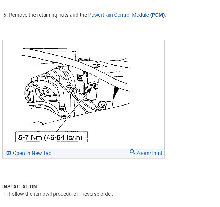

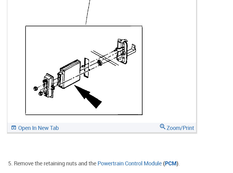

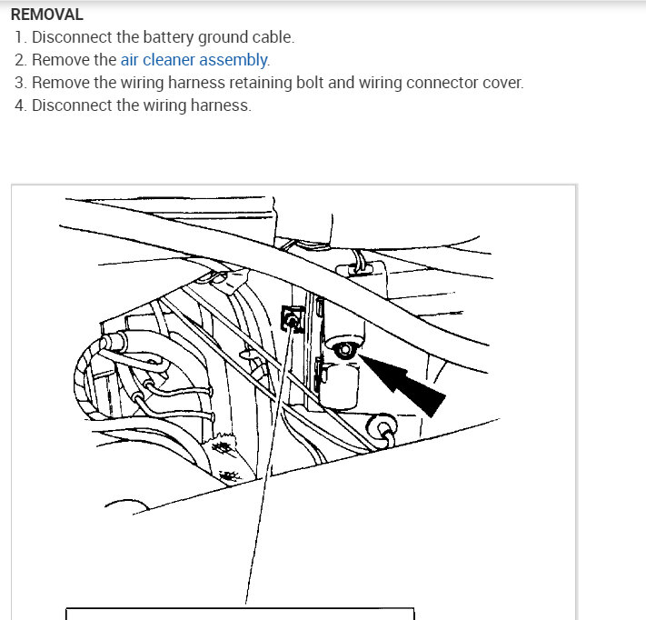

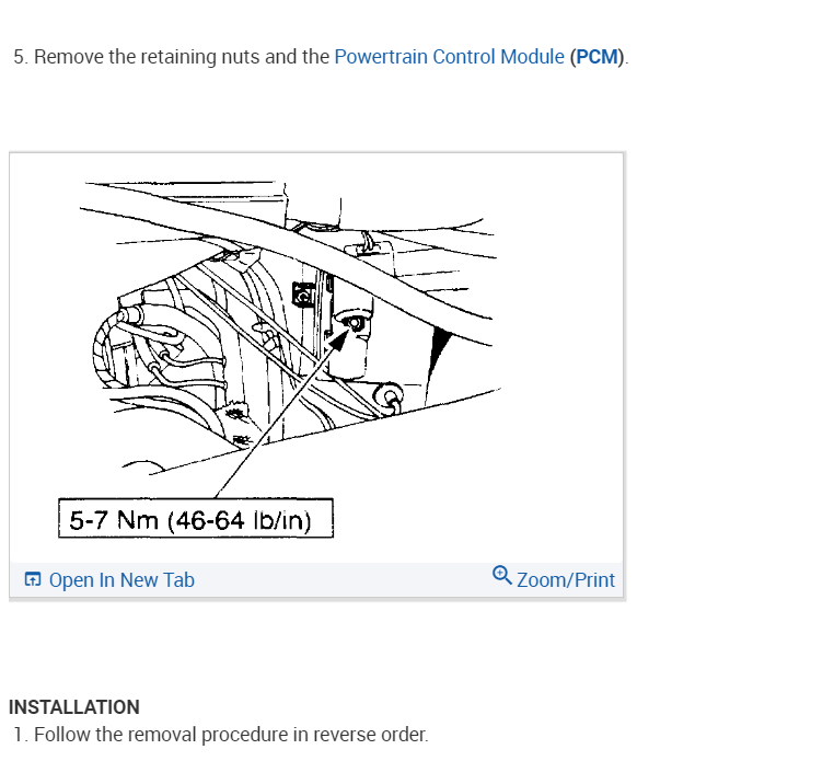

would like to know where the PCM is located.

The engine control module or PCM is located on the driver's side firewall under the hood, Check out the images (below). Please let us know if you need anything else to get the problem fixed.
