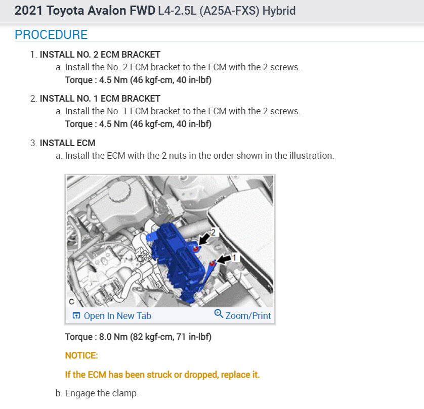

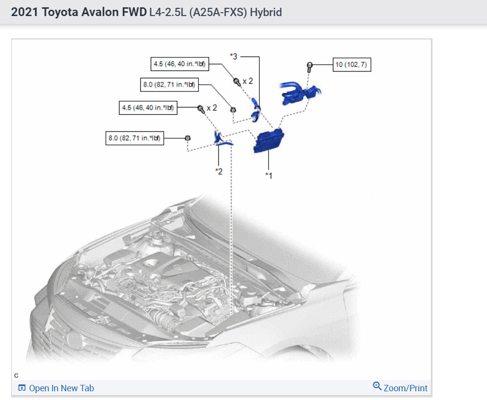

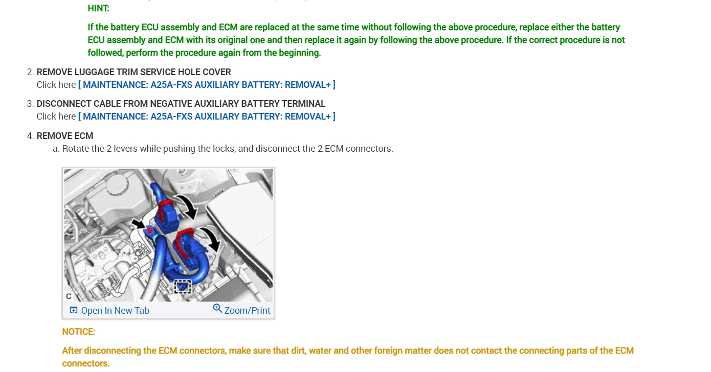

I’m Try­ing To Lo­cate The Com­puter As­sem­bly, Dri­ving Sup­port Unit (part# 88150-07030) on A 2021 Toy­ota Avalon Hybrid. Can any­one help me lo­cate the unit? I removed the glove box but couldn't find it behind the glove box. Any help is appreciated—many thanks for considering my request.
May 24, 2023 at 4:02 AM
  • 55,224 POSTS

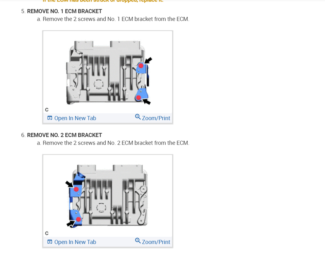

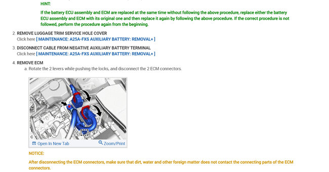

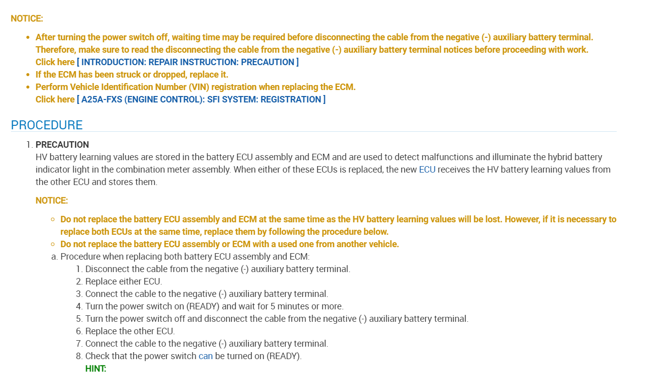

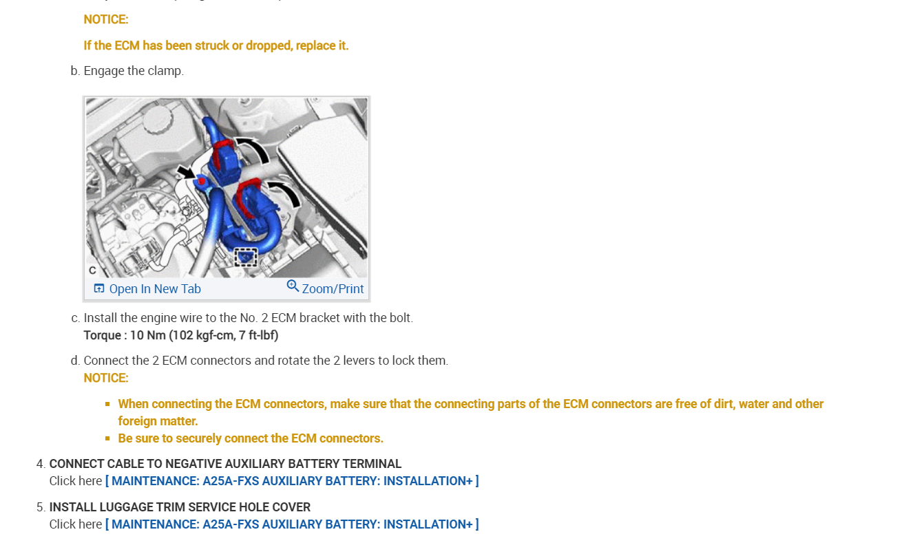

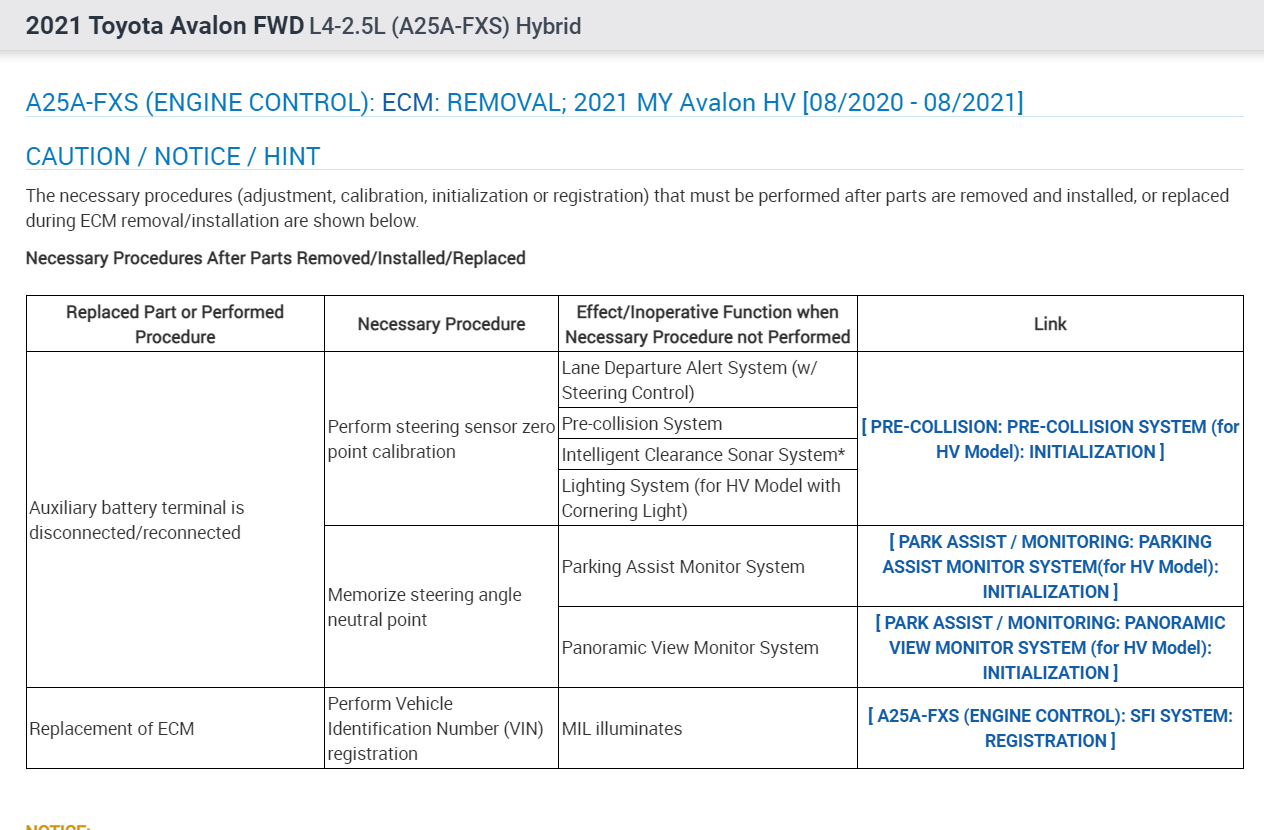

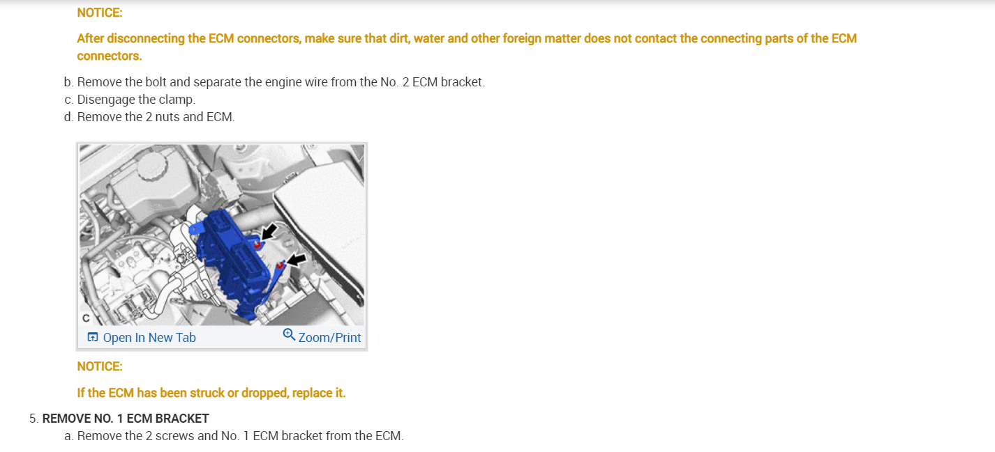

Here is the location and how to change out the main computer PCM. You can get a preprogrammed unit by searching Google or Ebay. Check out the images (below). Please let us know if you need anything else to get the problem fixed.
