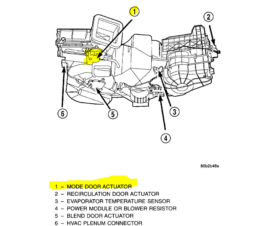

cannot get the nobs to switch from defrost to face and feet,
Jan 2, 2020 at 11:05 AM
  • 110,251 POSTS

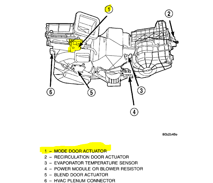

If you can't change the air flow direction, it sounds like a problem with what is called the mode door actuator. That is what changes the air flow direction.
What I would suggest is to remove the actuator and see if is responding when you change air flow direction. If it isn't, just confirm there is power to it when changes are made. If there is power, replace the actuator.
Here are the directions for replacement. The pic attached correlate with the directions.
___________________________________________________________
2000 Chrysler Concorde V6-2.7L VIN R
Mode Door Actuator Replacement
Vehicle Heating and Air Conditioning Air Door Actuator / Motor Service and Repair Procedures Mode Door Actuator Replacement
MODE DOOR ACTUATOR REPLACEMENT
The mode door actuator is an electric motor. It mechanically positions the A/C unit panel/bi-level door and the floor/defrost door. This actuator contains a feedback strip which allows the computer control to know the exact position of the mode door at all times. The mode door actuator is not serviceable and must be replaced if found to be defective.
Mode Door Actuator Locations
See Pic 1
The mode door actuator is located on the lower left side of the HVAC unit housing.
REMOVAL

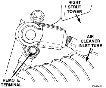

1. Open hood and disconnect the negative battery cable remote terminal from the remote battery post.
2. Remove left and right underpanel ducts.
3. Remove floor console.
4. Remove center floor heat adaptor duct.
5. Remove rear seat heat forward adaptor duct.
6. Loosen center support bracket and pry rearward to gain access to the actuator.
7. Remove actuator retaining screws. Then pull actuator straight down. Upon removal, note the shaft position of the actuator, because the shaft on this motor is keyed. When installing new actuator, its shaft must be positioned in the same location.
8. Remove electrical connection on actuator.
INSTALLATION
For installation, reverse the above procedures.

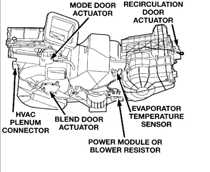

the heat won't come on just the cold air, where is the blend door actuator at?
Nov 2, 2020 at 7:26 AM (Merged)
  • 55,817 POSTS
The temperature blend door actuator is on the passenger's side attached tot he heater plenum. Here is a guide to show you what you are info when doing the job.
Here is a diagram (Below) for the location on your car
Nov 2, 2020 at 7:27 AM (Merged)

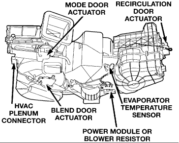

How do I replace the blend door actuator on a 1998 chrysler concorde. I ran the diagnostic and the code was 23
  • 75,988 POSTS
Blend Door Actuator Replacement
HVAC Door Actuator Locations
The temperature door actuator is located at the bottom of the heater housing at the center tunnel.
REMOVAL
Negative Battery Cable Remote Terminal
Remove left and right underpanel silencer/ducts.Instrument Panel, Gauges and Warning Indicators/ Instrument Panel/ Service and Repair. See: Instrument Panel, Gauges and Warning Indicators\Instrument Cluster / Carrier\Service and Repair
Remove two screws from actuator which are accessible from the right side of center stack.
Remove one screw from actuator on left side.
Pull actuator straight down from shaft and disconnect electrical connection. Upon removal, note the shaft position of the actuator, because the shaft on this motor is keyed. when installing new actuator, its shaft must be positioned in the same location.
