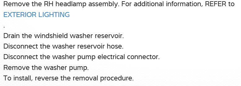

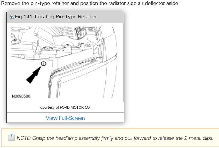

I'm trying to locate and replace the washer fluid pump. I was told I would need to remove passenger side headlight. I'm concerned about being able to properly realign that. Any other options?

you don't have to worry about realigning if you don't mess with adjustment screws. see pics then pull 3 bolts for headlight and disconnect electrical. do not turn on washer pump until fluid is in jar.
