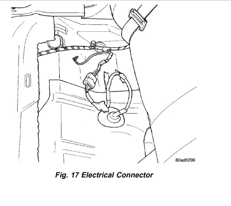

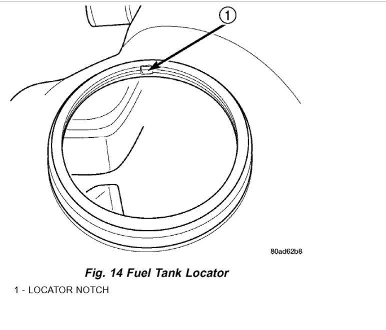

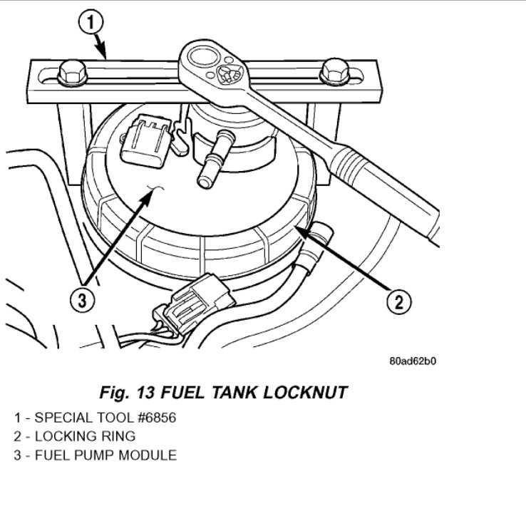

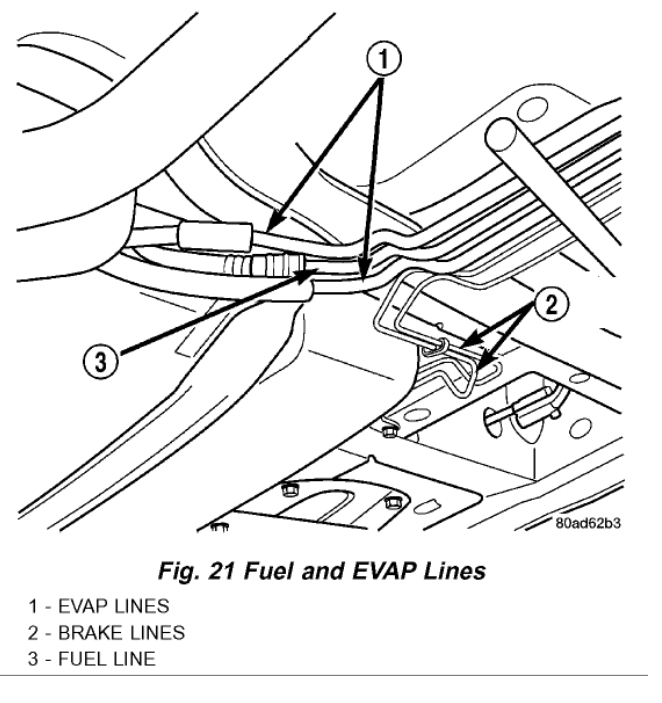

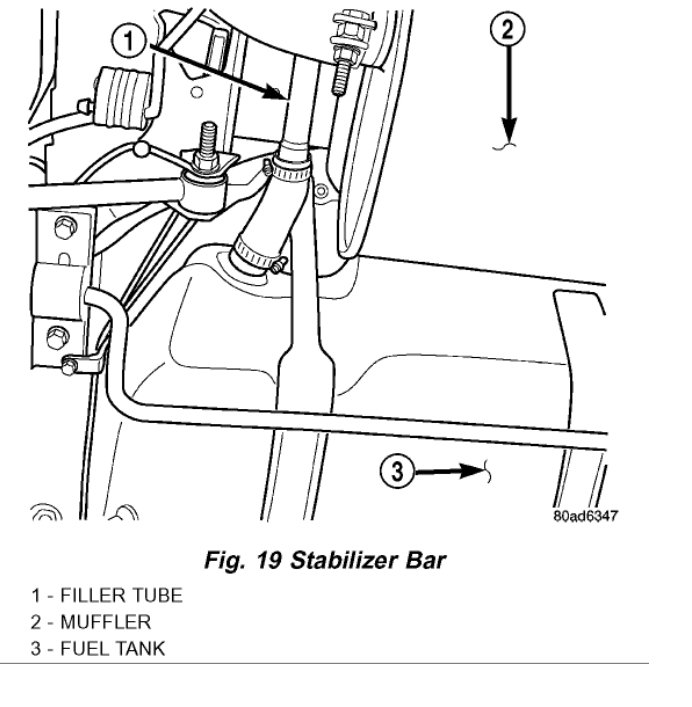

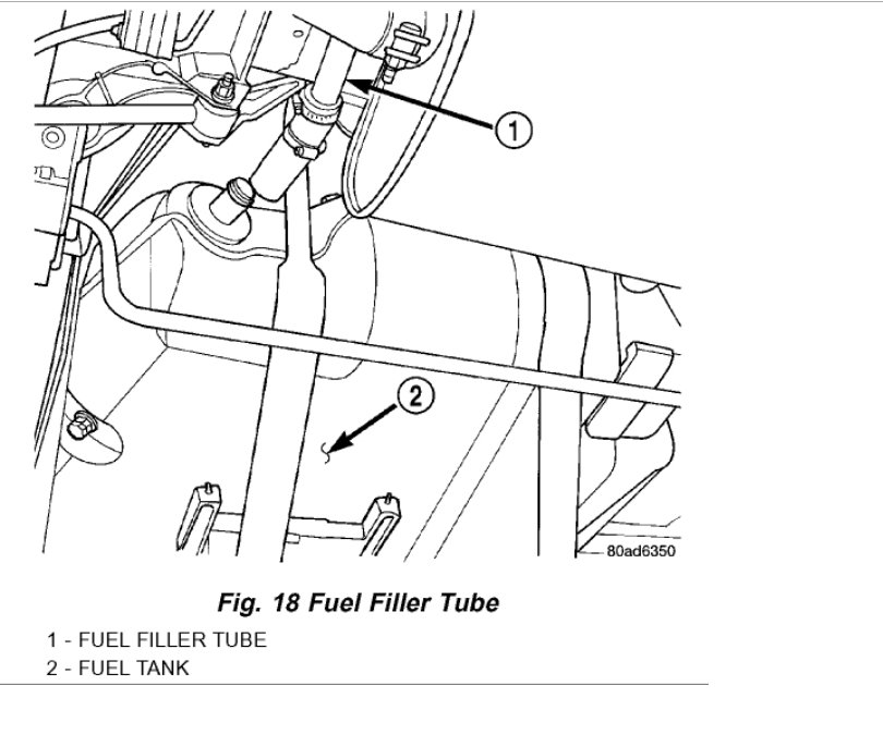

Car sounds like it wants to turn over but it will not catch.
Oct 3, 2017 at 11:50 AM
Experienced Mechanic
55,628 POSTS

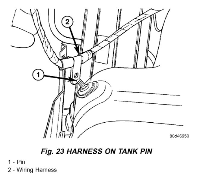

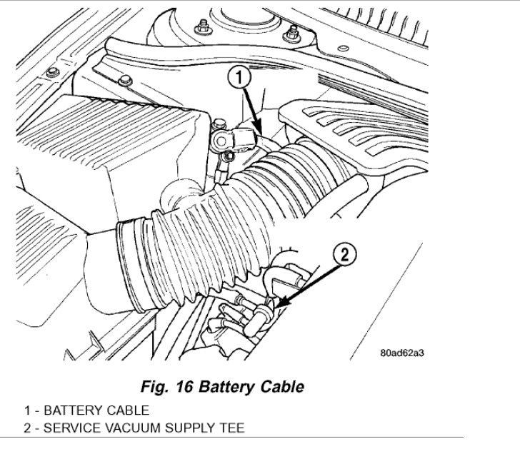

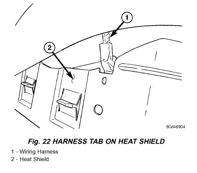

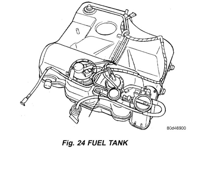

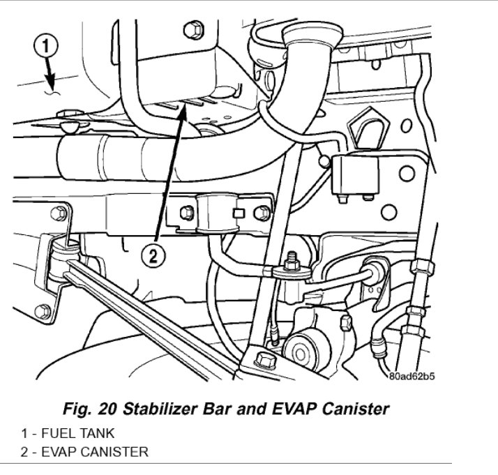

Fuel pumps do go out on these cars all the time but I would check the fuel pressure before replacing it.
Here is a guide to help:
and if found to be bad this guide will give you an idea of what you are in for when doing the job.
https://www.2carpros.com/articles/how-to-replace-an-electric-fuel-pump
Here it is on your car (below).
