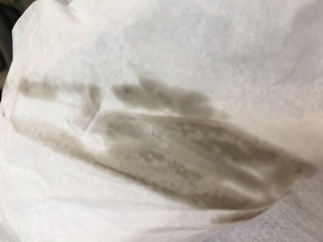

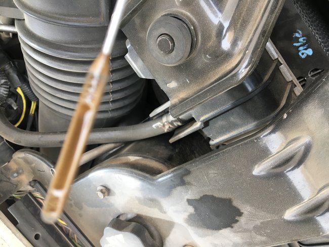

I will post pic oil gauge how it locks and after i wipe it i changed oil two days ago i drove it about 30km.

The oil looks okay, the white smoke means the injectors are bad or the engine is worn out and the compression is too low not burning the fuel completely. You say the noise level is better with the new oil? It might be all you can do; some engines are noisier than others.
