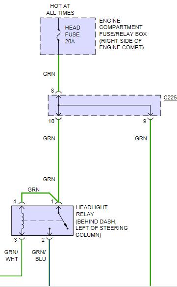

I would like to know if my vehicle has lo/hi beam headlight relay or is the only one fuse only

see pic one fuse and one relay for both. if no high or low beam may be a bad multifunction switch. Check out the images (below). Let us know what you find.
