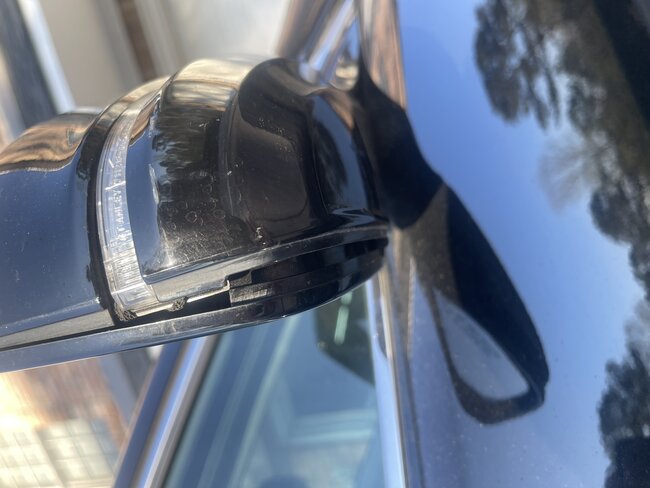

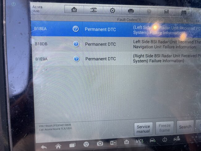

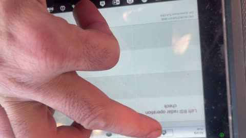

It''s all related. The "LKAS has a problem" message is on as well pre-collision warning system and am sure BLIS is also off. I scanned what am Abe to communicate with ad got this. I don't even see where the side cameras for the BLIS are on the mirrors but I see on the inside of the door that it does have it.

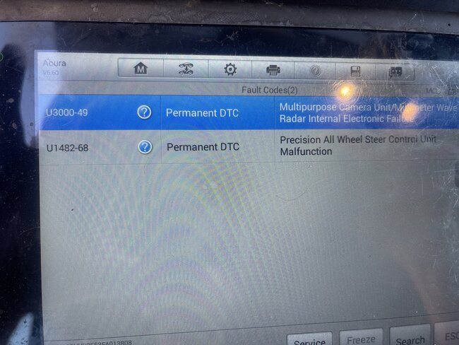

From your screenshots, the big one is:
U3000-49 - Multipurpose Camera Unit / Millimeter Wave Radar Internal Electronic Failure
No, the BSI sensors are not in the mirrors. They are radar units behind the rear bumper corners. And based on your codes, I would start by diagnosing the front radar/camera system. I would clear the codes, then turn the car back on and without driving it run the codes again. That way we can see which comes come sus first.

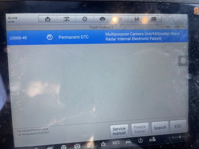

I cleared all but I cannot communicate with all systems as they are separate, scanner says not supported, but with the main camera I have the code even after I clear all; u3000-49

Yep, so the "Multipurpose Camera Unit" is up by the rear view mirror, I would check that out and then get a used one from ebay and try that, these camara are subject to heat which makes them go out. Then clear the codes and let me know.

relaced it with a used one and all lights are now off. thanks!
