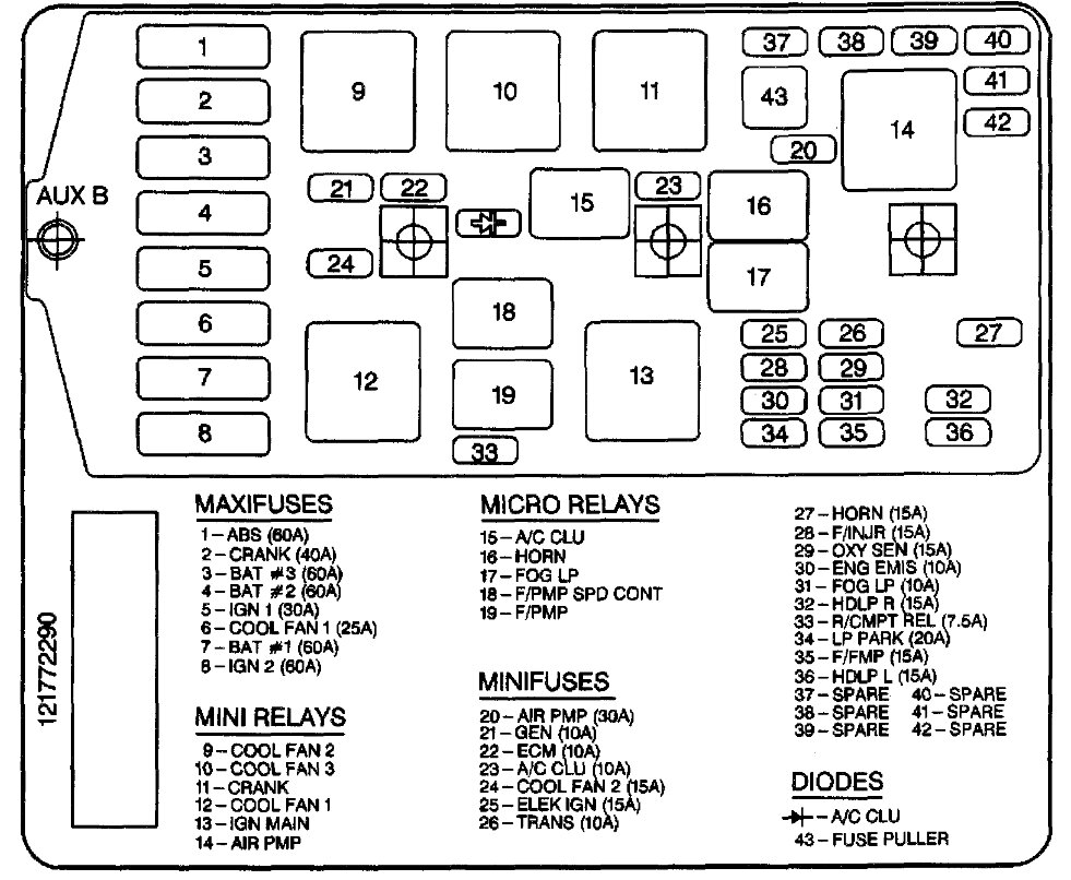

I am trying to locate the little mega fuse.

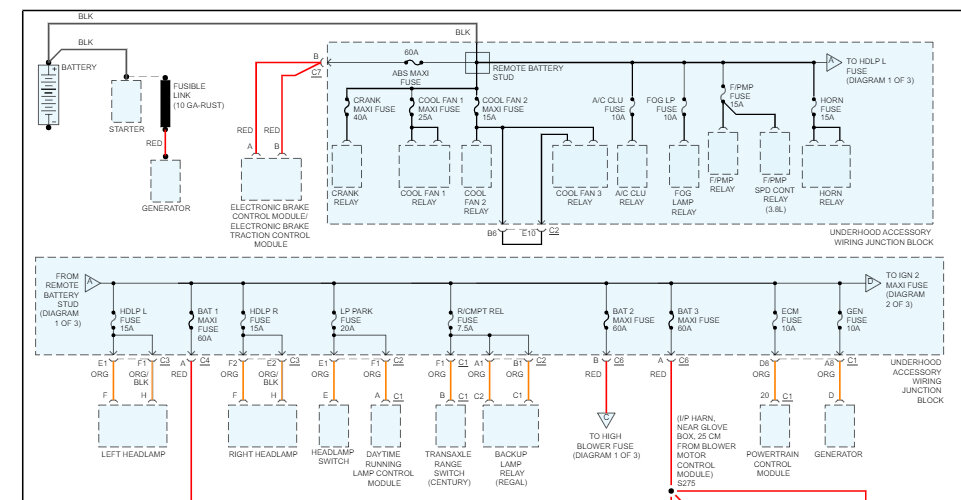

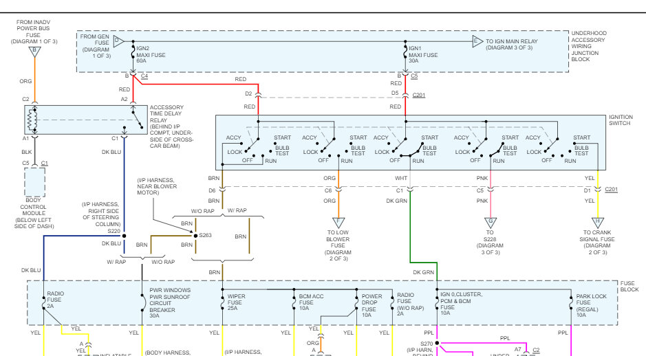

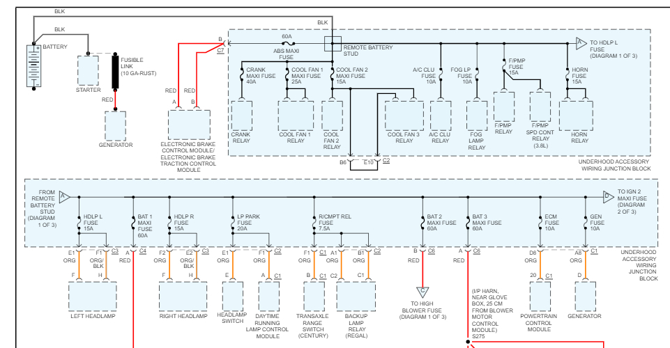

Little? There are many here is a wiring diagram to help clarify. Check out the images (below). Please let us know what you find.
