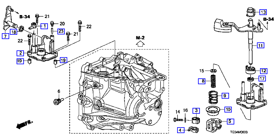

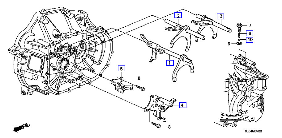

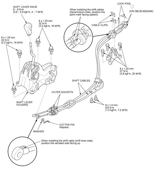

i am looking to find name or diagram of five speed so i can no the exact of what the parts are. but it only had the top gears of shift pattern witch were 1,3,5 and 2,4,R, did not work. and just now when i went to put in first the gear would not catch any gears at all. i took off the center console to look under at the shifter. and the part looks like a type of air shock (compared look is like a screen door air shock).

Here is the interior linkage diagram. It sounds like you may have a bad cable. To determine if it is the shifter or the internal linkage in the transmission (they like to bend shift forks) watch the levers on top of the transmission as someone shifts through the gears. If both cables are moving in/out and the levers are moving the problem is internal to the transmission.
