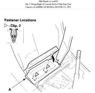

My center console door won't stay down what holds it's down how do I fix it?

Hi NinnyBoo, The lid is mechanism are gear operated push open and push close functions. If it is not closing, the locking tab is faulty and you would have to replace the console pocket as an assembly. Here is a diagram for removal.
https://images.2carpros.com/forum/automotive_pictures/192750_ConsolePocket06AccordFig03_1.jpg
