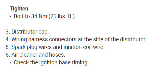

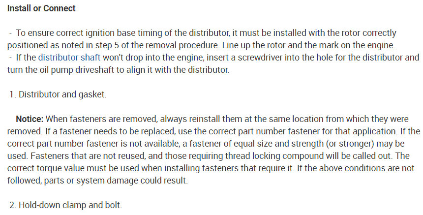

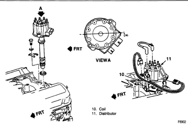

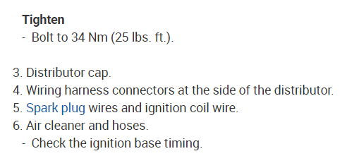

I don’t have my distributor lined up right for my truck listed above with a 454 engine.
Oct 11, 2020 at 1:56 PM
DANNY L
  • 5,648 POSTS
Hello, I'm Danny.
When you removed the distributor did you mark where the rotor was pointing in relation to the distributor base? I've attached a few picture steps below. Hope this helps and keep us updated. Thanks for using 2CarPros.
