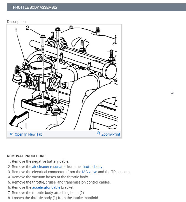

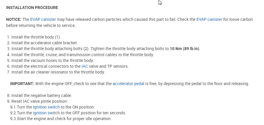

Line that goes from fire wall to throttle body name
186,000 MILES • 2.2L • 4 CYL • 2WD • AUTOMATIC
TIMNDEBI
About 6" long, harder material, not really flexible. Both ends have rubber type connectors. It's brittle, that's why it broke. Notice car hesitates when the break in line/hose comes apart. Have it taped with liquid electric tape. Works for now. What is the name of part. I've Goggled everything. Nothing! Thank you
Nov 10, 2019 at 4:02 AM
Can't say I know which line you are talking about with that information. Can you get a picture of the line and make sure you get where it goes into the throttle body and the firewall?

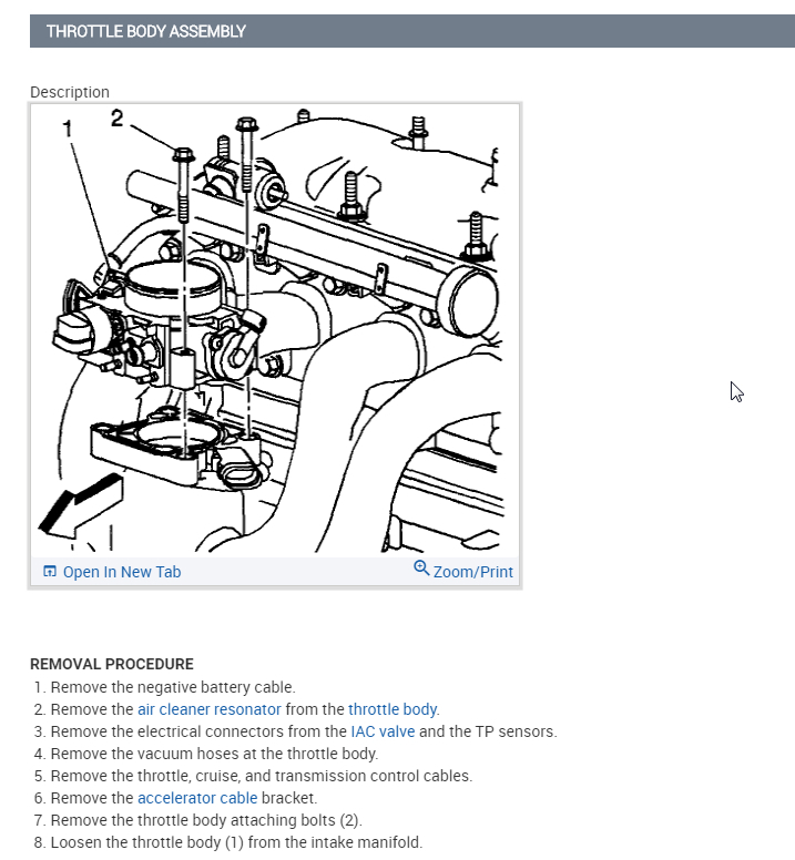

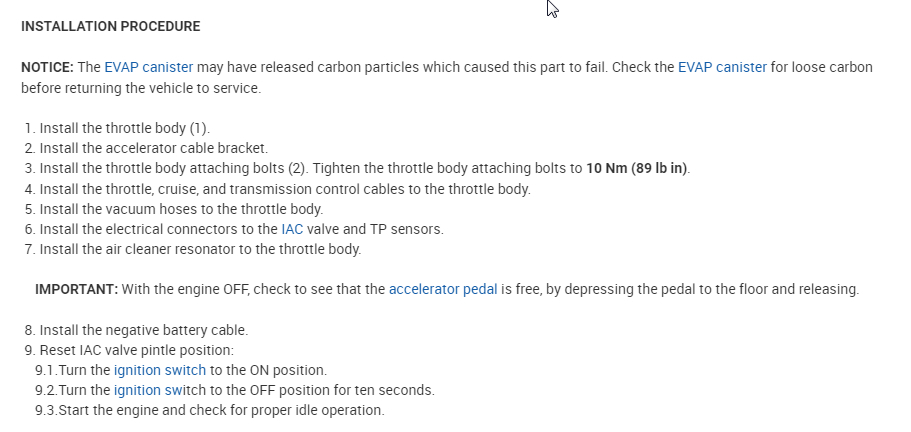

Here is how you remove the TB. Do any of these lines look like it?
Nov 10, 2019 at 9:48 AM
I am sorry. It was pointed out to me that this did not have any attachments to it when I clearly meant to post them. Here are the images that I meant to post last time.
Nov 11, 2019 at 11:05 AM
