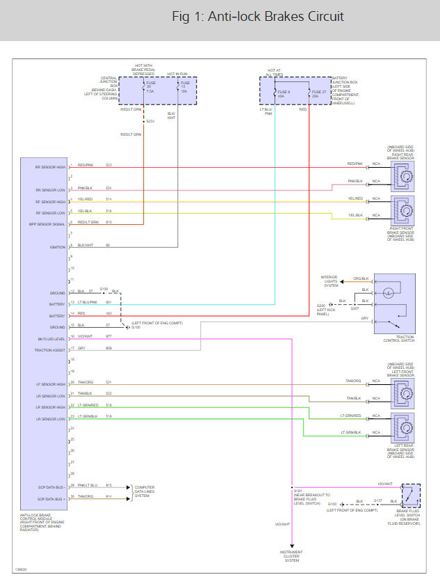

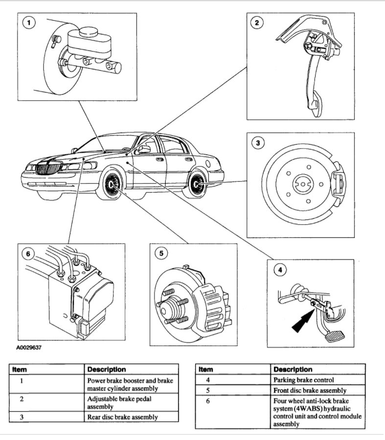

I have added the guide to show people what they are in for when doing the job and a diagram (below) that show what it is like on their car.
https://www.2carpros.com/articles/how-to-replace-a-abs-controller

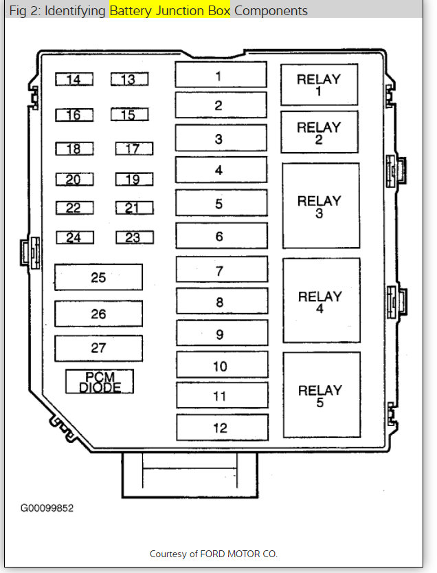

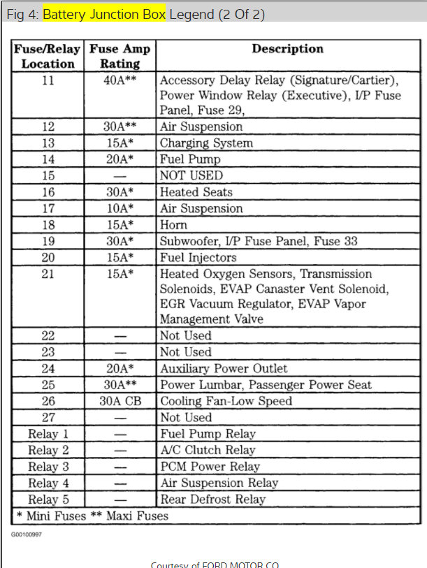

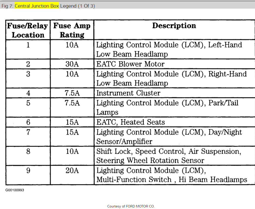

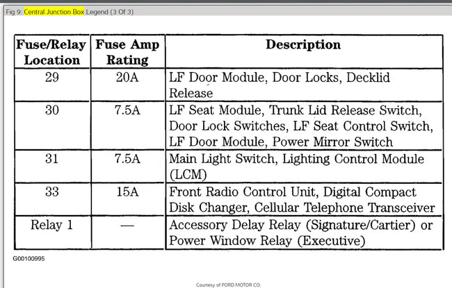

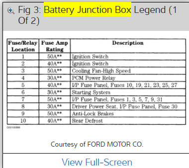

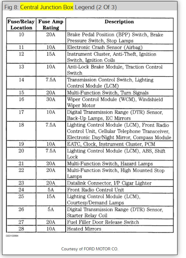

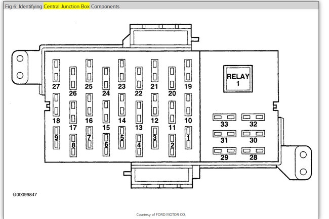

It sounds like you are losing power somewhere there are 4 fuses that run the system you could have a bad connection at one of them. Here is a guide to help you test the fuses and the wiring for the system.
and
