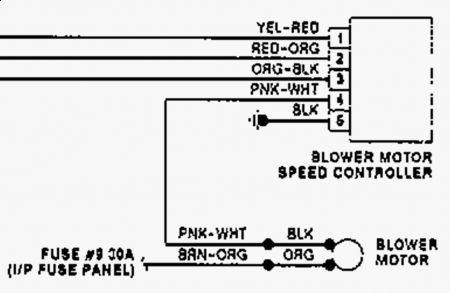

How could I test the blower speed control module? With the module off the car is the resistor in/or on the module accessable so it can be be solder repaired with high temp solder?
What else does that module control, or does it only control the blower motor speed?
Can the module be bypassed so that the fan will still work on high, after I take it off to inspect/try to repair it/or replace it, etc and how could I do that, with some improv, but safe wiring?

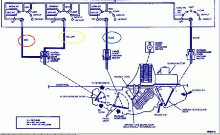

Floor vent setting has no response at all (no fan), but def/floor works fine, full flow at both vents???
The floor vent setting has not worked for a long time or has never worked (no response, silence) since I've had the car 3 years, but the max ac, ac, vent, def/floor, and def all work good.
Does that mean that the A/C/Heat Control switch itself has a short at the floor vent setting? Can that part of the switch be solder repaired, with the whole switch out of the dash?

I did find one forum question that mentioned the ATC system and the blower motor speeds for this car. It was about the ATC and the A/C system not working as good as it should.
While responding to the question it was mentioned that when the blower motor goes on high, it has/uses its own seperate ground wire and the module has a relay for this.
Sometimes a problem with the other speeds could be related to the seperate ground wiring, for those other speeds and not to a faulty part.
Or the problem is the blower motor speed control module itself.
One of the forums mentioned that they sometimes have to be fixed or replaced because of solder problems with those units.
What is your diagnosis and/or suggestion on how
to test and fix the low-med/high blower speeds and the floor vent setting having no response (fan shuts off at this setting)?
Where/how do I check for proper ground for the different speeds that involve the speed control module.
There's alot of harnesses, wires and locations.
Which harness/location/what color wires will I be
checking/testing?
How/where do I check about the grounds?
I have a digital multimeter.
To test for ground the ohm meter is used to check for minimal resistance on full high speed, right?
I've never checked the fuses in this car, which ones should I check?

Test VBC like this, Blower On High Speed In All Switch Positions 1. Disconnect VBC connector in engine compartment. Turn ignition switch to ON position. Set controls to MAX A/C, medium blower speed. Using voltmeter, check for at least 10 volts between connector terminals No. 3 and No. 5 while changing blower speeds. If voltage is not as specified, go to next step. If voltage is as specified, check and repair wiring harness. 2. Disconnect terminal No. 2 from VBC connector and reconnect connector to VBC. Turn blower switch to low speed position. If blower is off (no voltage at blower motor), check and repair wiring harness. If blower is operating at high speed, replace VBC. you have no resistor because you have ATC system, flickering lights are usually caused by vlotage regulator on the back of the alternator, it can be changed without replacing the hole alternator, but getting the brushes in requires patience and two needles to hold them in place, also check battery cables.

[Test VBC like this, Blower On High Speed In All Switch Positions]
Did you mean do all testing starting in the high speed setting and then switching to the other speeds?
Because the blower is not running on high in all switch positions:
There is no response from the blower motor when the vertical moving ATC speed switch is any of the variable speed settings between auto and full high (low - med/high has no response at all).
Only full high works in the full high setting. If you slide the switch down just under the full speed setting, the blower motor shuts right off and does not work until you go all the way down to the Auto setting, and the fan only works on high in Auto, no other speeds.

The only vent setting that doesn't work is the floor vent (the fan motor shuts off at this setting), but def/floor works fine. Can that part of the switch be repaired? What's wrong with it?

What about the floor vent setting, it shuts down the fan, but def/floor works fine and so do all of the vent settings.
If I take the dash apart to get at the vent settings control can the floor vent setting be cleaned or repaired.
How do I get the floor vent setting to work?
