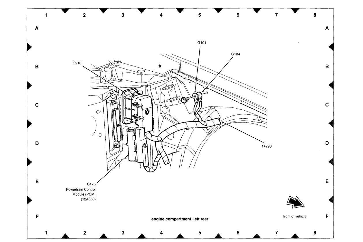

I purchased a used 2003 Lincoln TC Executive. The dealer did not know the keyless entry door code. The owner's manual says it's stamped on top of the powertrain control module. Where can I find it? I live 60 miles from the nearest dealership.

The ECM is located on the left rear side of engine compartment on firewall and is removed from under the dash. Here are diagrams below for you to see. Check out the diagrams (Below). Please let us know if you need anything else to get the problem fixed.

It is also in the trunk on the right support arm.
