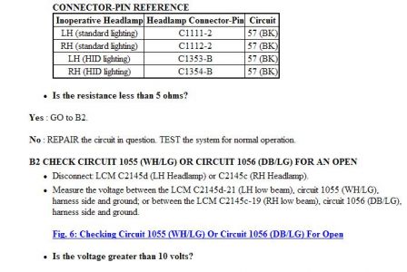

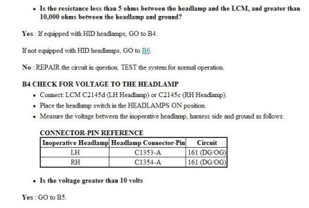

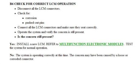

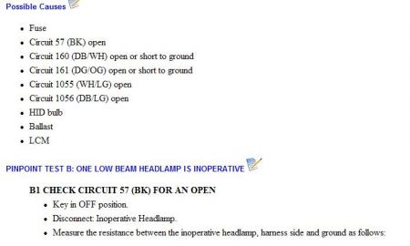

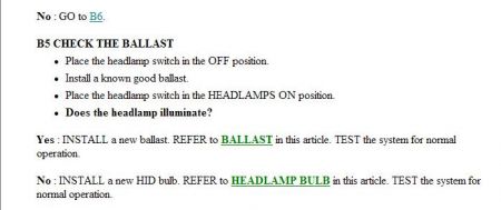

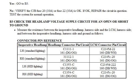

Below is a list of possible causes for one low beam to not work, along with procedures for diagnosing. If one of the steps leads you to the removal/installation of a component that you do not understand how to do, just let me know and I will follow up with additional instructions on that specific component.
https://www.2carpros.com/forum/automotive_pictures/261618_Noname_37.jpg
https://www.2carpros.com/forum/automotive_pictures/261618_Noname2_12.jpg

https://www.2carpros.com/forum/automotive_pictures/261618_Noname3_6.jpg
https://www.2carpros.com/forum/automotive_pictures/261618_Noname4_4.jpg
https://www.2carpros.com/forum/automotive_pictures/261618_Noname5_2.jpg
https://www.2carpros.com/forum/automotive_pictures/261618_Noname6_1.jpg
