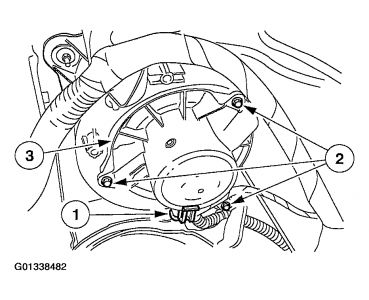

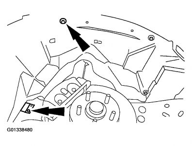

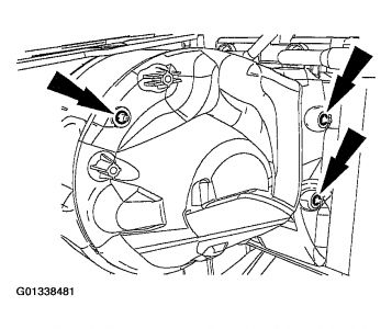

The blower motor is just starting to squeal especially on higher settings.
I'm mechanically inclined but how do I get to it to remove and replace it?

Hi Robert, The blower motor is located on the passenge side engine compartment..... You have to remove the washer fluid reservoir... remove screws from rear fender apron and set apron aside.
https://images.2carpros.com/forum/automotive_pictures/188069_03Lincntowncarblomotrfendrscrews_1.jpg
Remove clip and the blower motor insulator...
https://images.2carpros.com/forum/automotive_pictures/188069_03Lincntowncarblomotrinsulator_1.jpg
Remove Blower Motor
https://images.2carpros.com/forum/automotive_pictures/188069_03Lincntowncarblomotr_1.jpg
