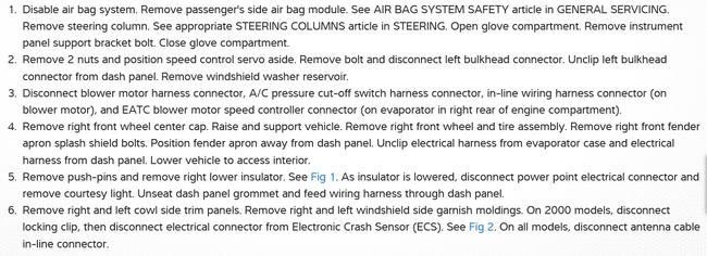

This jog is not to bad, it will take a little time but well worth the money you will save doing the job. Here is a guide that will give you an idea of what you are in for doing the job.
https://www.2carpros.com/articles/replace-heater-core
You might what to replace the heater core hoses as well
https://www.2carpros.com/articles/replace-heater-hoses

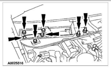

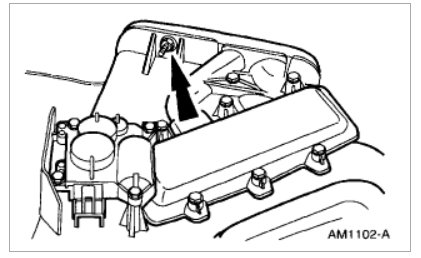

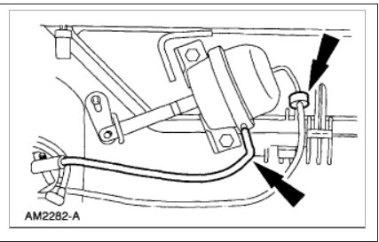

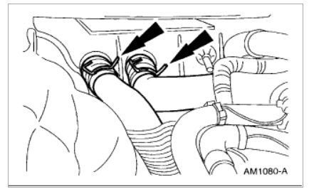

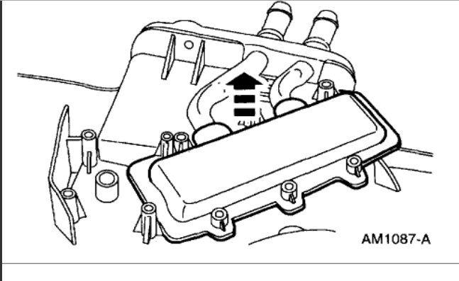

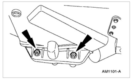

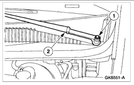

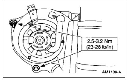

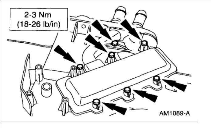

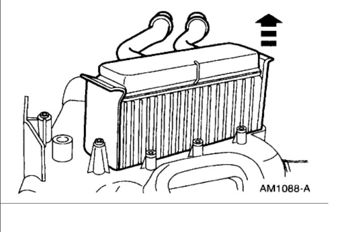

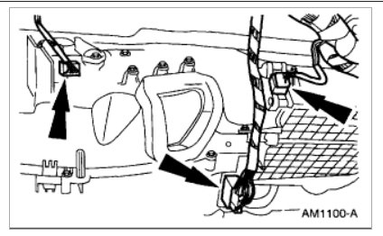

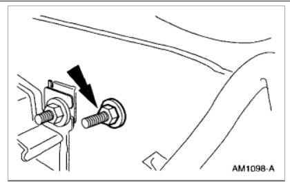

Here is what the job will be like for your car (below)
Nov 13, 2017 at 9:17 AM
HMAC300
  • 48,601 POSTS
to by pass just get a piece of pipe that fits on hoses and clamp it on both ends with hoses.to replace the heater core the dash has to come out.

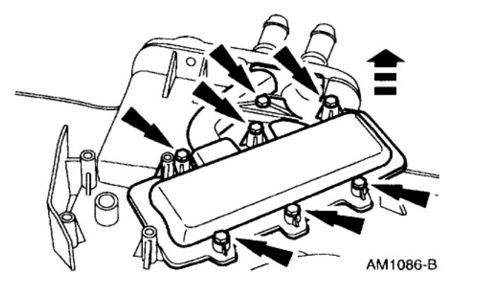

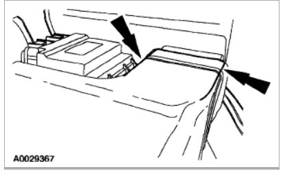

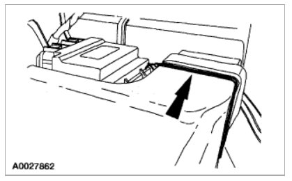

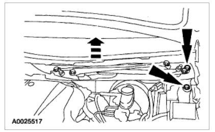

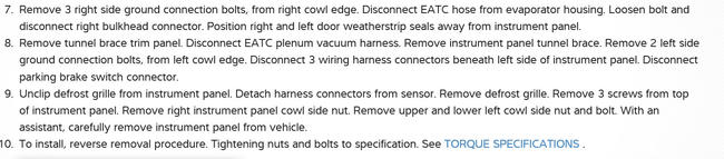

yes it has to come out. see pics
Nov 13, 2017 at 9:18 AM (Merged)
POPPYJOHN
I don't see any pictures
HMAC300
  • 48,601 POSTS
they are there unless there is an x in a box. click on them and try to enlarge them so you can read it easier. I can't do much on this end with that.
